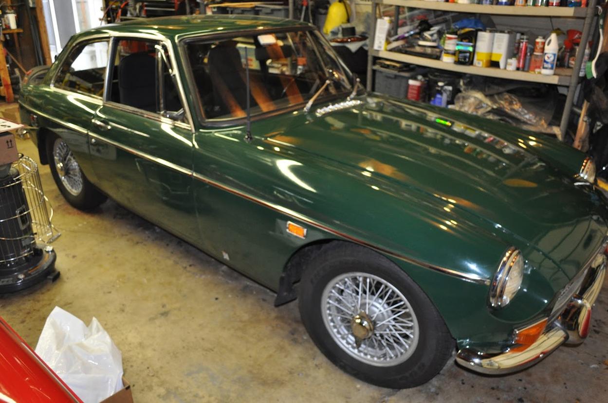

I just started powder-coating a couple weeks ago on my british car project. Your limiting factor will be baking the powder. I have a 16" oven and use it for things like brackets, but rock sliders are a whole different beast. You're going to have to invest in a serious oven to do that.
This might be one job you want to farm out.
For what it's worth I am sand-blasting in my cabinet, pre-heating the part in the oven, using the Harbor Freight powder coat gun with Prismatic Powder. Don't waste your time with the HF powder. The matte black is especially ugly.
