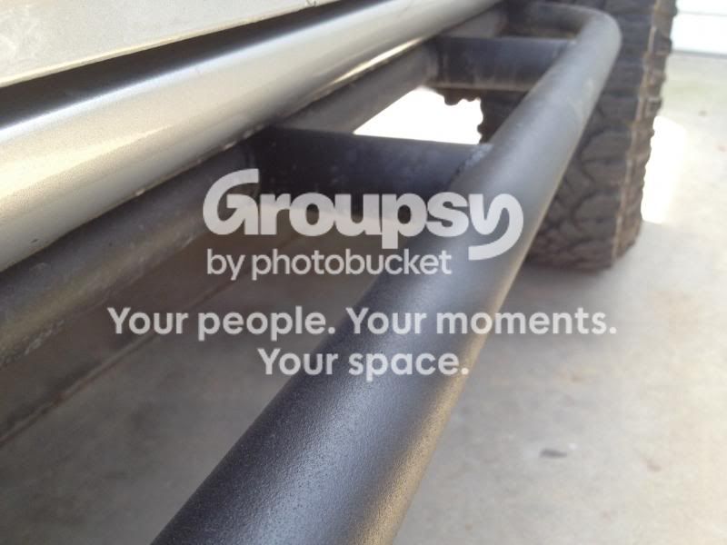

On my addicted front bumper and sliders I used the rustoleum (sp) bedliner in a can. I personally think it's awesome, you get a little texture (which is nice on sliders for grip) and it's pretty tough. The best part is everytime I knock some off I just spray a little bit for a touch up and it's good as new.

Lol. It's not sand paper brochacho. Maybe I should take a pic to show the detail. There are no rough edges or anything like that. It's just a nice texture.
Here's what it looks like so people can stop saying don't bedline it!
