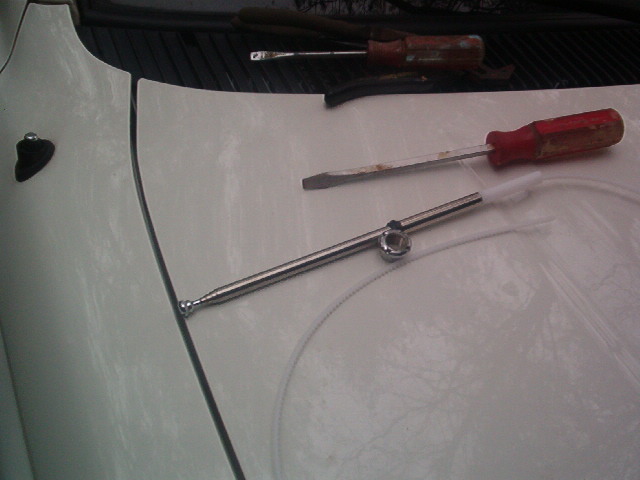

The noise MIGHT not be the motor. A lot of people generally have problems with the antenna mast. The white plastic that pushes/pulls the antenna up/down tends to break. I've gone through two of these already on my '96 and am highly considering the taco whip mod so I don't keep dropping ~$50 just to listen to the radio. I didn't search the motor for broken pieces (old one seemed intact) and just installed the second one. The 2nd one probably broke b/c I didn't get all of the broken plastic out before installing the new one.
I agree. In my 4Runner, the motor would work and the mast would only go up a little. The motor moves a white plastic cord with bumps. The teeth on the white cord wear out. I bought a new mast for $48 at the dealer.
It might very well be the motor, but it sounds like the antenna is wearing out.
http://www.toyota-4runner.org/showthread.php?s=&threadid=25072&highlight=antenna
Eek! screwdriver on the paint!!! haha.
somehow I managed to fix our old 96's antenna when I was 11 years old, do not ask me how, because I had no idea I could perform anything like that; the only thing I was good at was washing it. I'm hoping my antenna doesn't decide to crap out on me, because I think I used my one free lucky repair up. God, I do love that 4runners were given an automatic antenna
It's probably the mast, not the motor. They crap out quite often on our 4Runners. My mast was replaced before I bought the truck.
Yeah, probably not a good idea. I use the screwdriver for hundreds of jobs and one of them is for screwing in screws. I am sure there is a better tool for the job.
