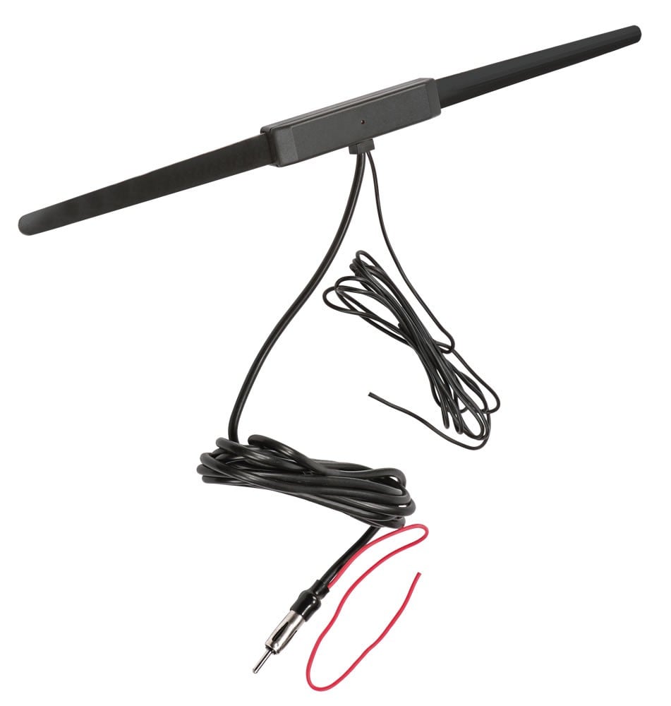

You can get one of these. I've been running one for a long time.
It's a power amped antenna. Sticks to the inside of the windshield.
This is what I have and I love it....
Where did you find this antenna? I can't seem to find anything good that won't cost me an arm and a leg. If need be ill do the taco whip conversion but that is quite pricey as well
