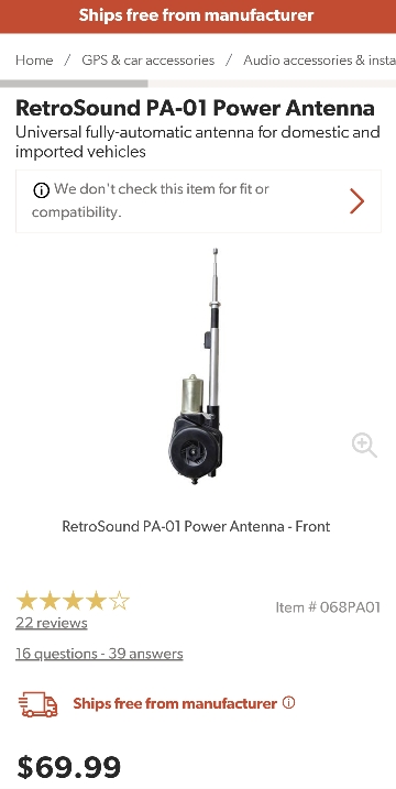

I know the factory part is like $135 from partsouq, but I found a universal power antenna at crutchfield for $70 with free shipping.
Made by RetroSound, has anybody installed PA-01 in a third gen?
How about any other, aftermarket power antenna?

Is your unit bad or is the cable/gear strip broken? Basically, do you hear the motor going by the antenna does not go up and down?
If that’s the case, you can get by with a cheap antenna only. I just did this a few months ago and it only cost me about 10 bucks.
If your motor is bad, that’s a different story.
The antenna snapped off, the motor works fine - I hear it run when the radio powers on. I barely use it to be fair but I'd like to fix it.
