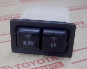

Sorry for digging up an old thread, but I would love to do this to my 93 so I don't break off any more antennas. I came across this switch (actually two buttons side by side) for an 80 series landcruider which would be cool to have since the buttons are illuminated (part 84760 60030). What I'm still confused about is; since this switch has 6 wires/pins, would it work with this mod or would there be additional wires that I'd need to splice into for full switch functionality (aside from the illumination)? I won't need the corresponding antenna relay for this switch, right? I have the option to get the relay but it's an additional $50...
I'm sure you could get it to work. I don't know how those buttons actuate, but you could probably use some kind of timed momentary relay Like this one and just time it to run for as long as it takes the antenna to fully extend, and then do the same with another relay to bring it back in.
If I had to guess, one wire is 12v in, then one ground and two 12v out that'd go to the relays for both buttons. Last two wires would be Illum + and -.
You'd need to take a multimeter or find a wiring diagram to see exactly what wire does what, but in theory what you're suggesting would work.
