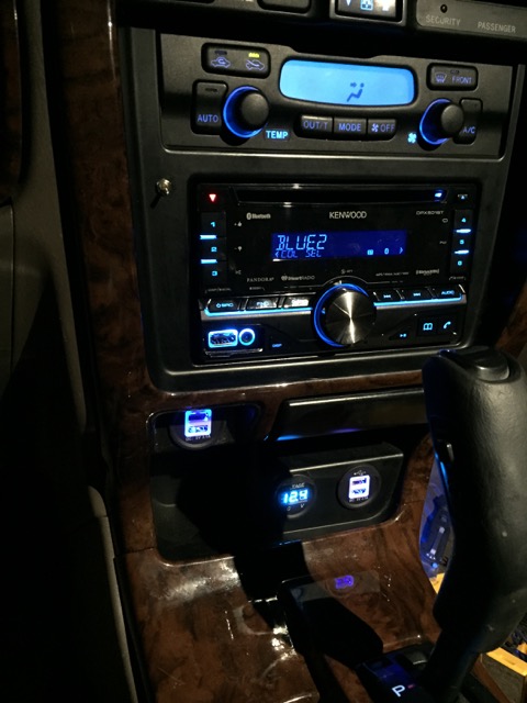

I did this as I was installing the aftermarket hu.
I love that switch!

Dude its so small and looks like its apart of the dash. I saw some of those at radioshack. I got a small round toggle with no lights. I was gonna stick it under the cigarette lighter. But your idea looks way better haha.
Yo show me a picture of your whole dash on your truck. I just did mine all white and yours looks awesome all BLUE
