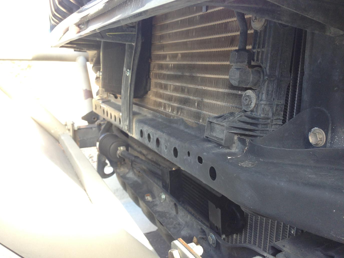

I added a Magnefine filter and that same cooler to my '02 Tacoma 3.4, mostly due to the high heat we have here (summer temps can hit 49C in summer). Mine was down low on the radiator support. I don't think it got much air flow, mostly it just added some fluid capacity. I have seen a cooler that is a large heat sink which would also work.

Thanks, That's kind of where I'm suspecting it'll end up. it'll be safe from impact, the kit comes with core mounted fixings, but I think I have enough in the way of my radiator/condenser.
I don't think they really need much airflow, as you said, the increased capacity helps, and a larger surface area to just radiate off as much as possible.
That's also the usual factory location. We don't get anything like that heat, but I can occasionally feel a difference in steering when the oil is hot.

[MENTION=138011]TorqueOfTheDevil[/MENTION] here's the cooler mounted on my Tacoma:
Thanks.. looks good.. I might as well get a Magnefine filter on there too.
I like the look of the second heat sink style one too. I'll have a measure up when I start fabbing brakets for my oil coolers.
Because of the slow speeds offroading, one that sits in front of the condenser will work the best. A cooler just hanging out by itself is no more than an extra length of pipe.
