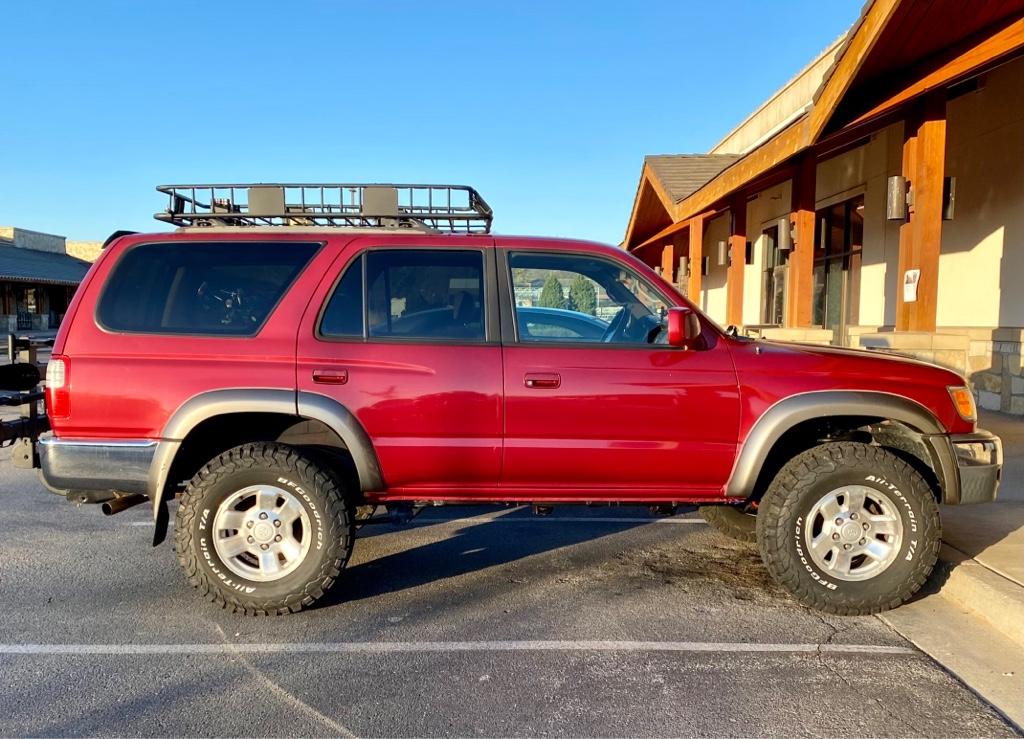

Ol' Ruby's frame off restomod thread.

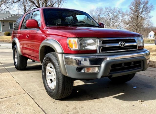

2000 Toyota 4Runner SR-5 3.4L V6 4WD AT Sunfire Red Pearl
(with Topaz Metallic large fender flares)
5VZ-FE engine
A340F transmission
VF2A transfer case (j-shifter)
4.10 axle gear ratio
215,xxx miles.

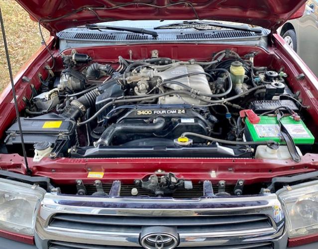

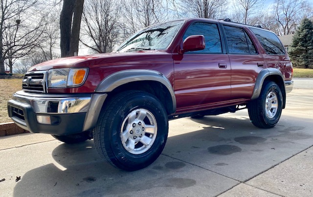

some more photos (before frame swap, lift, tires)

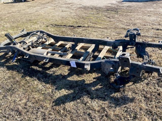

I should add that this forum has been essential to my learning about our trucks and gaining the confidence to fix things myself. I've never really worked on vehicles before getting this truck, and I'm learning so much and really enjoying myself. So, thanks everyone!! :hippie:

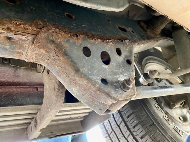

Dope! Looks so clean inside and out. Is the frame pretty bad?
Thanks!
The frame is actually not too bad, other than one area of penetrating rust. It's on the inboard side of the passenger rear lower trailing arm mount weld seam, which is a common problem area on these trucks.
EDIT: After starting the frame swap, it's clear there were other problem areas, including the rear shock upper mount goblets around the mounting bolt holes.
I read a lot of threads here, including [MENTION=10169]TheDurk[/MENTION] 's Frame Rot!! Is this the end?, when deciding between repair vs swap. In the end, I decided to go with swap since there might be other problem spots that are hard to see, and it's also possible that the frame is rotting from the inside out, and I wouldn't know it until things started failing. I'd like to get out ahead of this rust rather than let it get worse.
I'll get more photos of the frame up soon when I start the frame swap thread. In the meantime, here's a photo of the problem spot, and of the donor frame that will get treated with POR-15 before the swap:

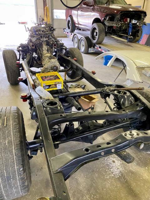

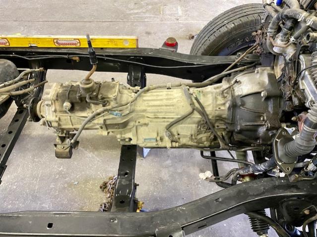

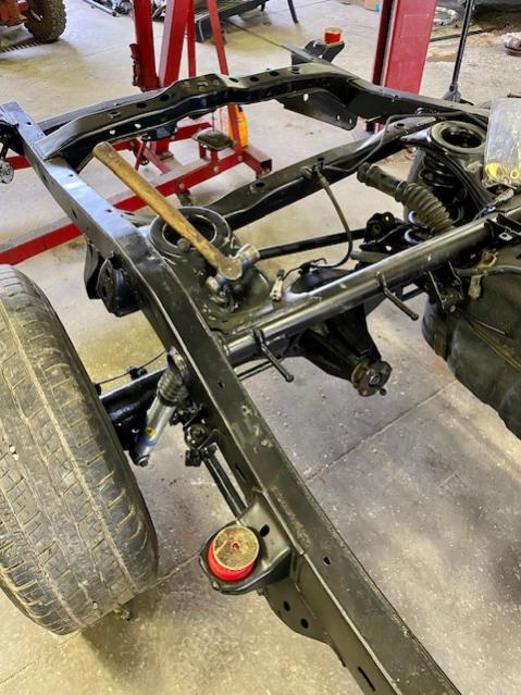

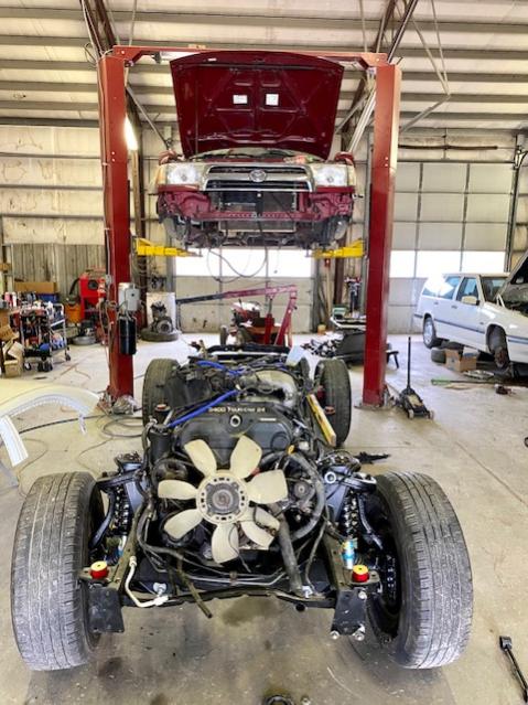

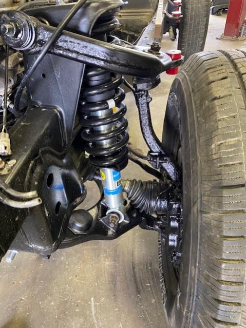

Some photos of things in progress... lots of internal coating and POR-15 on the new to me frame.
In photo showing the back of engine and transmission, you can see the oil from the leaky cam seals.
Also, enlarged the drainage holes in the rear shock upper mount "goblet".

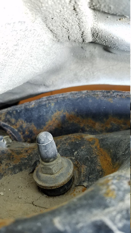

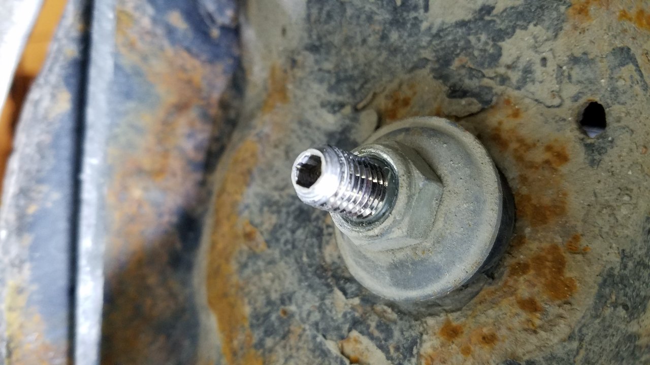

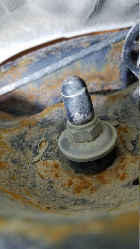

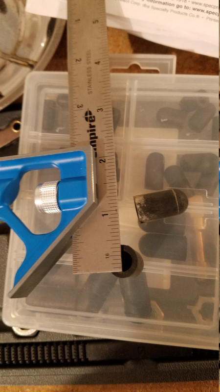

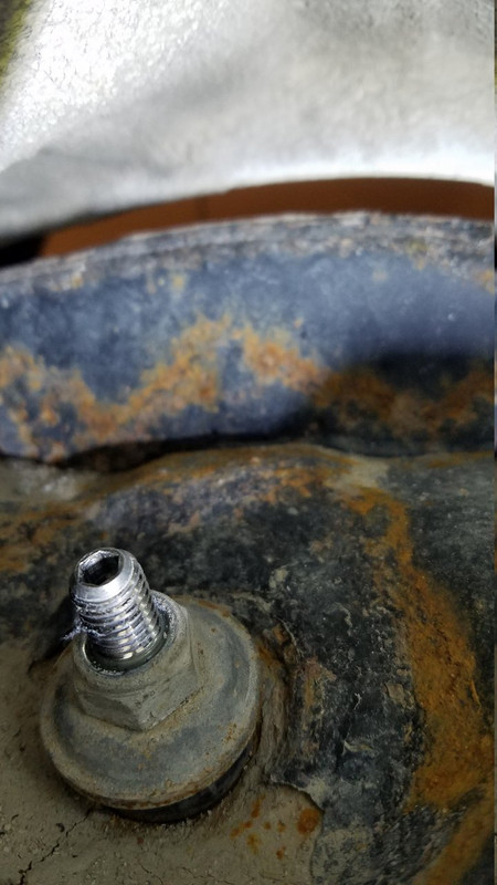

[MENTION=9502]repo[/MENTION] suggested not only slathering the bolt with antiseize, but also smartly added to the suggestion that i put a long vacuum cap on top of each. i used the caps i had, plus filled them with antiseize, but having all that direct access would be soooo nice.
I crawled underneath and looked at them to confirm this actually works and isn't bro science and those threads and hex sockets are completely pristine after 3 winters! I used anti-seize because that's what was handy but silicone grease or white lithium (I think is safe for rubber? I dunno) should work. The point was to repel/displace any water that might get inside the cap, but they were still on extremely tight. I used 5/16" vacuum caps, there's no UV exposure or anything down there so works fine. I thought they were longer but they are just normal size. Hopefully saves a headache down the line.
Great build BTW, imagine how good it will feel having a totally clean frame like that. I feel weird polluting a build thread with my own pics so let me know if you want me to move them.
Right side:
Left side to make sure:
Caps:

Thanks for sharing, repo. That’s awesome! Glad to hear it’s working.
