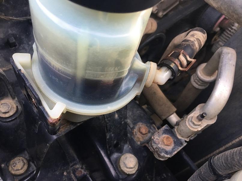

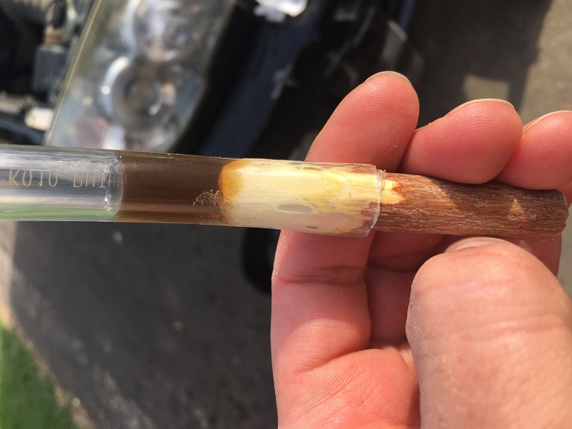

A couple of things. First, I simply plugged the "dead" end with a dowel, which I made myself out of the stick I found I found. You can see it on the first photo attached. Second, I did not use any pump to get the old fluid out. I put some paper towels right under the connection of the hose to the reservoir and placed an empty Pepsi bottle (whatever the volume of the small one is) right after I disconnected the hose. Also, there is no need for the clamp because there is no pressure in the system and the fluid flow to the easiest route to escape, so it will not leak regardless of the presence of the clamp.
The fluid in my vehicle was of "diluted" fresh engine oil colour (see the first photo). Supposedly, it was changed at roughly 80,000 km. Today the Runner has just over 205,000 km. I still can't believe the results, to be honest.

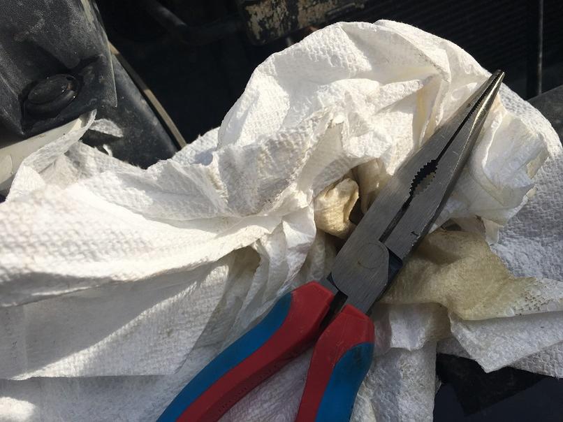

The second photo shows that there was no mess, really. I have not cleaned up anything and that's what it looked like after the change. The only "spilled" fluid was on the hose itself as can be seen on the photo. The third photo shows the paper towels that were under the hose when I disconnected it. So really, not much of a mess at all.
