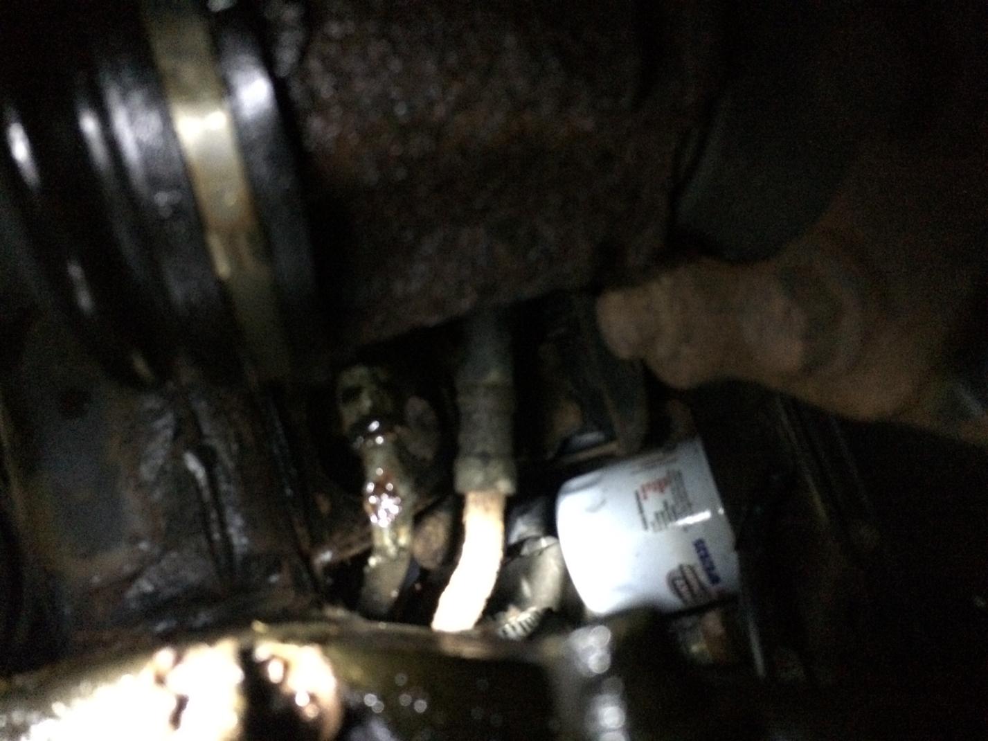

UPDATE: it's not the rack, I was looking I was completely dry, but there was a line next to the oil filter that seems to be leaking down onto the cv joint. Sorry for the bad pic, but is does anyone know which line this would be? Sorry again for he bad pic and description, I'm in te school parking garage and people are looking at me like I'm crazy as they see me underneath the car ha

Is that fluid red/purple, or is it straight brown/yellow? It looks to me like you might be leaking engine oil since your picture is looking straight up at the oil filter. Check your dipstick.
Its a combination of ATF and PS fluid, so its a redish brown. It is definitely power steering, oil level is perfect. In the picture, it is the first line from the left, farthest from the actual oil filter. I'm assuming its a high pressure power steering hose?

If you can confirm the that hose is leaking and it isn't just that the engine oil is dripping down onto that hose, or if something else is just dripping down into that hose, then yes, you can replace the PS hose, but it is going to be a PTIA.
The hose fitting are very difficult to get off, especially when you have rust, you will definitely need fuel line wrenches. The hoses are stupid expensive, but you won't have a choice there, the high pressure line is about $150, and the return line is I think $30-40. Don't buy it from O'Reiley's, whatever brand they sell. I bought from them and it has already rusted severely before it has even seen a single winter.
You should reference the steering rack replacement threads to find out how to change the hoses. It's a secondary part of the install but you'll get an idea of what kind of PITA it is.
The wet line in your picture is the return line, so assuming that is what is leaking, you lucked out (be sure to confirm first though, while you may have lucked out the return line isn't THAT easy to replace). If you can get the fitting off the rack then that is pretty easy. If not, then you can pull the hose clamp near the rack and pull the hose off the fitting. It's not a high pressure fitting, so it's easy to replace. There are a couple mounts that are a pain to get to that you will have to take off.
Nelson, you've been a huge hell thanks. It was the line. Needless to say, I had to get the lines from the dealer and the end bill is $537. I was able to save money doing the radiator myself though.
