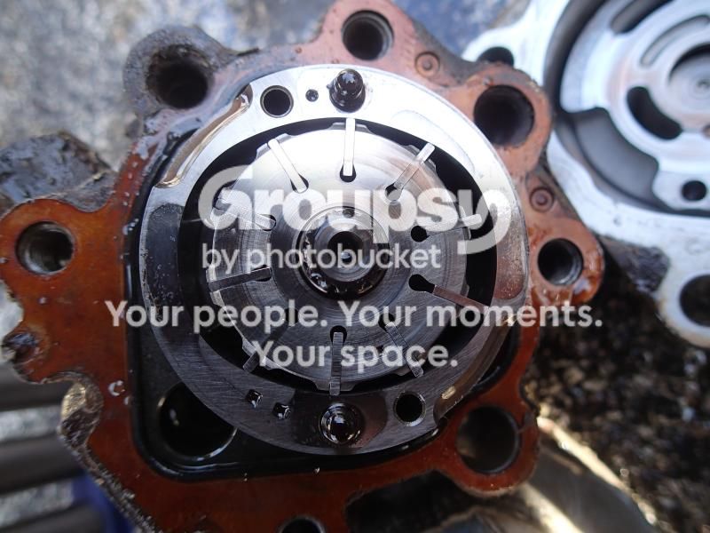

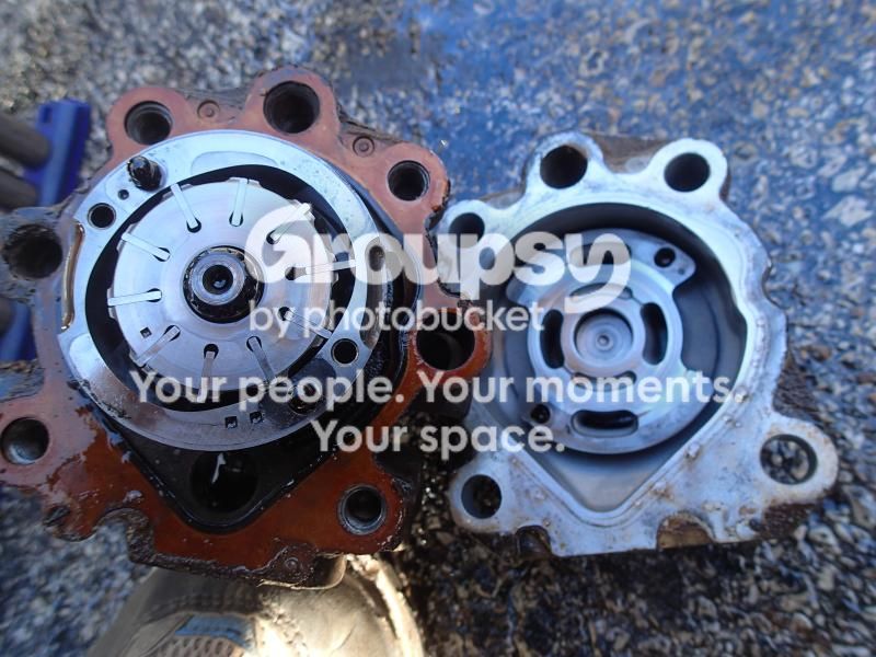

Okay, don't laugh. I got curious a few weeks ago and tore my old one apart. Just unbolted it and it opened right up.
see the clip on the shaft?

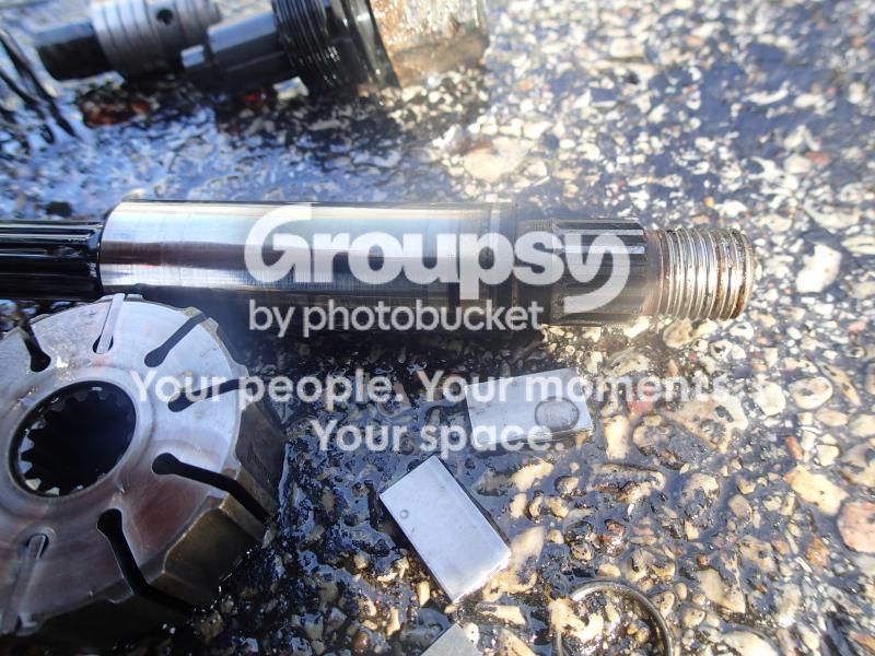

here's another pic (bottom right corner, goes on non-threaded side of shaft:
P2067050_zpspp7v0xx1.jpg~original

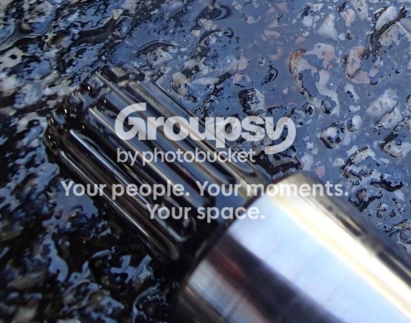

Here's a pic of the clip side of the shaft:
P2067048_zpsl53bhxly.jpg~original

So I'd be curious as to what's happened in there and how it could come apart as described unless the shaft broke or? I should have been paying more attention while I was fiddlin' around!
IF you were going to take it apart maybe have one returnable ps pump on the side, in case it isn't a fixable?
[MENTION=5345]habanero[/MENTION] that's some great work there on the PS pump. There is nothing wrong with taking stuff apart to learn the way they work, I've done it to many of things, problem is putting them back together in working condition.
