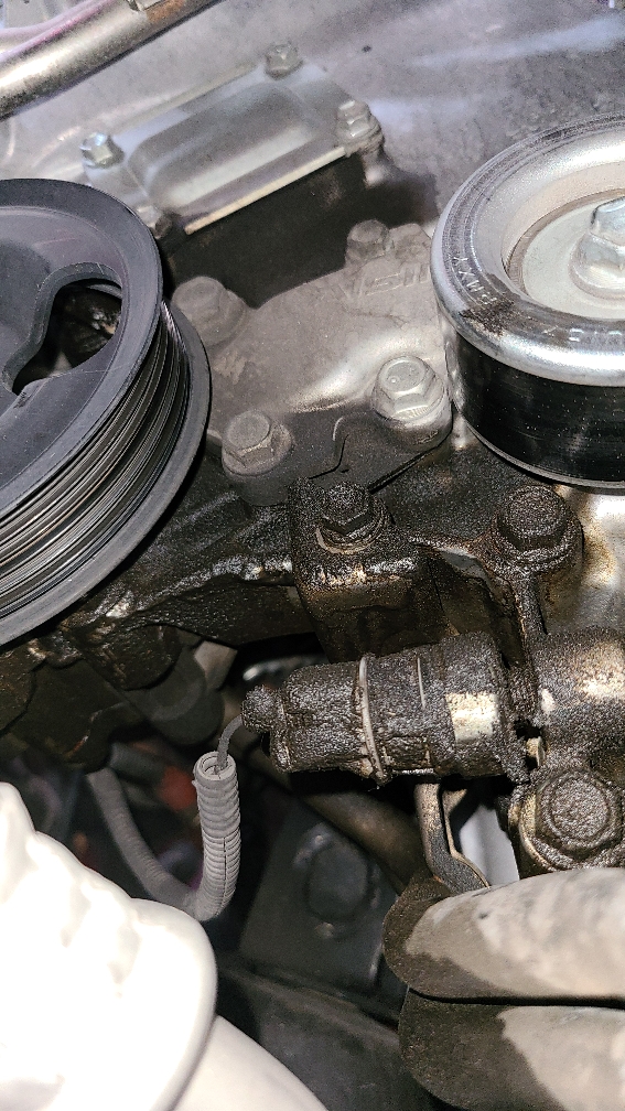

I was changing the oil on our 2010 this weekend and I noticed a lot of build up on the front, passenger side of the block as well as below on the front skid plate and rear one below the engine. I thought it was an oil leak at first but the dipstick did not show any loss of oil and there is fluid slung on the lower area of the passenger cylinder head. My guess is a shaft seal leak on the PS pump. Has anyone had this happen on their 5th gen?
I've found some low mile used pumps but it looks buried in the accessory setup. I can change the pump in 20 minutes on my 4.7L Dakota but this looks like a frustrating job. The PS reservoir was only down about 1/8" and was barely below the "hot min" line and was recently driven. I don't know if the expense and time (read frustration) is worth it for such a minor leak. I don't see any drips to completely diagnose this issue either. Thoughts?

The oil leak has yet to leave a stain in the driveway but there is a layer of it all over the passenger side of the block and skid plate. The lower portion of the head is more of a dusty oil cake. It does not seem to effect the level and it comes back when I clean it, which is really only annually when I change the oil. It's not the PS pump as initially thought.
2 things. A, it's a 4Runner. B, it's a major repair to fix.

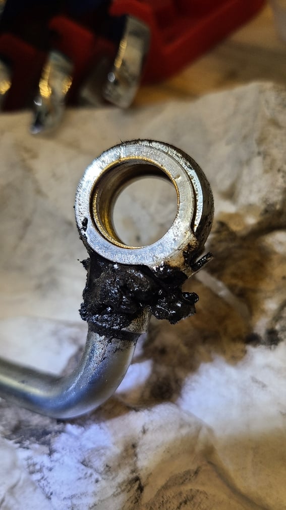

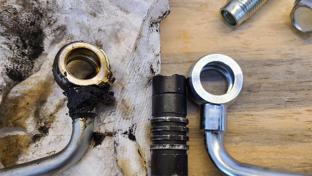

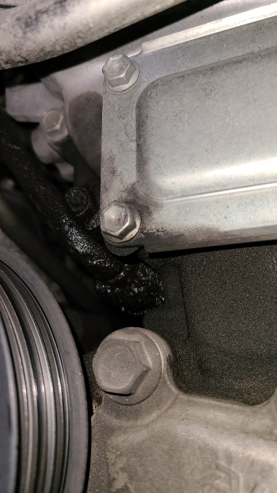

So, while browsing the "What did you do to/in your 5th Gen today" I came across a post from [MENTION=147414]EddieV4runnin[/MENTION] that intrigued me. He too thought at first he had a PS pump leak but is fairly certain it was actually the passenger-side VVT-i line. My leak seemed to be emanating from the lower connection to this line as well, so I figured why not go ahead and swap it out!
Just completed it two nights ago and so far it's clean under there. Did it fix it? Don't know yet.... but it may be worth looking into in your case. Unfortunately, it's a biotch to see up in that area from above, below, or from the wheel well. Here's the parts list for the job anyway. Good luck to you!
15772-31010 Pipe, Oil
90401-16043 Bolt, Union X2
90430-16016 Gasket, lower end of the line
90430-16012 Gasket, to Valve cover X2
Bolts may not be needed, but I replaced them anyway.
Banjo bolts are 48 Ft Lbs
Power steering pump bolts are 32 Ft Lbs
You need to disconnect the PS pump and let it hang to access the lower bolt and remove the air filter to get easier access to the top bolt. Whole job took me 2.5 hrs from beginning to end.

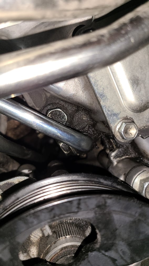

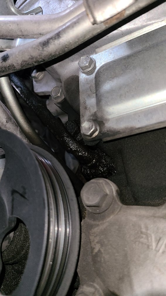

Here's a few pics. Does yours look like this?
I created an account just to thank you! I too found oil leaking around the PS pump but not from the valve cover. After reading your post and taking a closer look, I noticed crusty oil all over the bottom end of that oil line exactly as described!

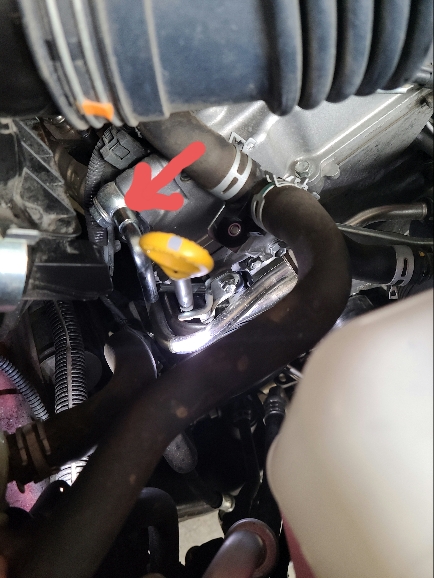

After seeing this, I'm almost certain I can be counted in for this leak. Definitely not as bad as yours but I first noticed a drip of oil on the bottom of the steering pump.
Traced it's way to the thicker gunk of the lower lower part of the VVT-i line as you described. The oil splatter is heaviest around that area looks like it's the source. Sprayed it off with Simple Green then soap and water. I'll be monitoring it to make sure it's coming from there.
What's the consensus if I don't fix this right away?
Would oil pour out from the bottom connection at all? Or do I need to do this during an oil change?
Thanks for those parts list and your tips for this job too.
I have just over 51,000 miles
