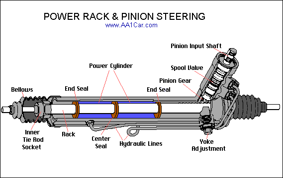

There is a little screen (filter) on the pressure side line in the rack, it could get plugged. if increased RPM does not help but it steers better under acceleration, it is likely it is just easier because of the weight transfer to the rear of the vehicle during acceleration. the weight shifts off the front steering wheels to the back making them momentarily easier to turn.
That sounds about like what I am feeling when I drive it. Is it possible to unclog/replace the filter instead of replacing the rack?
It can be possible, I did it on my black one. I was working at a dealer at the time and i had them do a flush afterward. Now... mine was not blocked all the way like yours it was just getting where it was harder to turn standing still.
since i did not do the work, i do not know how he cleaned the screen, I suspect he just pulled the lines at the rack and cleaned them with some sort of brake cleaner. then hooked them back up and did the flush. once you undo the lines at the rack you may be able to clean it pretty easy.
Also worth mentioning...if the center seal goes bad in a rack you can get the same results as you are having
The pump could also be weak, just because fluid moves in the reservoir doesn't mean the pump is producing enough pressure on the output side. I'm trying to figure out what it could be and how to properly diagnose it as the center seal could also cause a similar issue. Anyone ever done a pressure test on a P/S Pump before? (I don't remember if I was taught to do that to be honest)
