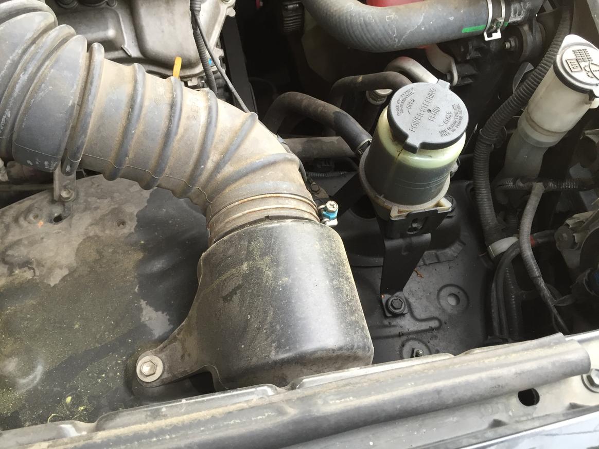

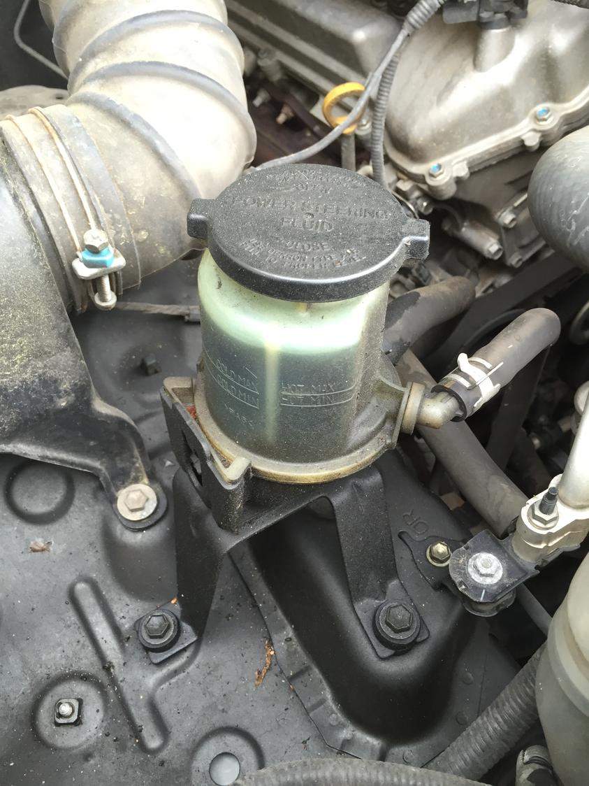

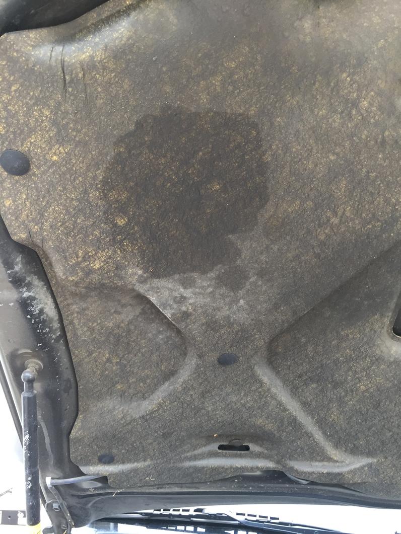

Please see the pic's below of my '07 SR5. Not sure if this is good or bad, as far as I can tell the steering seems fine. I drive this daily and it has about 232,000mi on it. I haven't noticed any leaks on the driveway and I've never flushed the power steering. Thanks!

I noticed mine puking out some fluid when I bought it too. I flushed it and overfilled it a touch. It puked out fluid until it was at it's happy level. Cleaned up the mess and all good now.
If it's never been changed I think I'd drain it all and then refill it to the proper level with new fluid.
I wouldn't necessarily be concerned with the level. If the pic was taken when it was hot, it is over filled. If it was cold, it is really over filled. It is a reservoir so a long as it isn't below the line and isn't over flowing, you are fine.
That is some nasty looking stuff. You really need to flush it refill. It isn't an easy process and you will waste a lot of fluid, but it appears to be in need. Your rack will thank you.

Maybe I misunderstood your question. Are you just asking about the color of your power steering fluid, or do you think it is leaking fluid out at the spots pictured? I just replaced the fluid in mine, and it doesn't look that much different from the outside. You might get a sample in a clear container and see if it is still a good color or not. Or just replace it.
