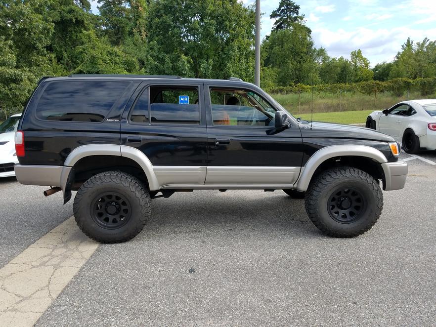

Thanks for the info. Ill throw on a picture because no one likes a forum without pictures.
