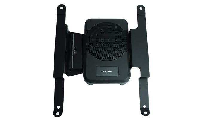

I would go with the Alpine, I had it all picked out before I went with my JL in the stock speaker box. If I couldn't fit the stock sub box I definitely would have done the Alpine

This is very helpful, thanks. From your alpine I can see the dimensions, so now I know what fits.

Alpine makes a Runenr specific kit:
Alpine | PSU-300FRN

Glad to help.
I see, yes in comparison to the micro sub I think you will be happy with these, I wired into the rear channels so that along with the EQ I can tune the sound more front for less bass.
On that Alpine model, there is also a bass knob option that I am not using as well as HP/LP filter knobs.
