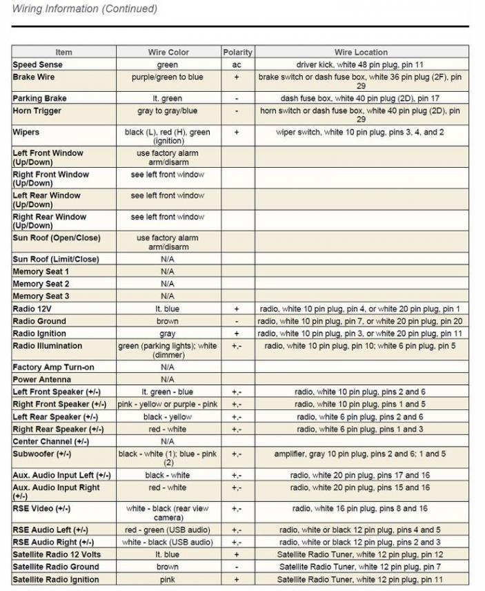

Ive decided to install a Kicker HS8 powered sub in my `17 T4R. I plan to use the remote power wire so that the sub powers on when the vehicle is powered on. Which wire on the head unit would I need to tap into to accomplish this?
I found this wiring sheet for a 5th gen. Mine is non JBL w/ nav. Still not sure which to tap in to.

Looking for any location that I could use for this wire without harming anything. Would be open to using any CD player wires if that is possible as it has never/ will never be used (by me).
Factory Amp Turn-On would normally be what you'd use, but it's really just a switched 12v
I believe you could also use the +12 ignition to essentially do the same thing, only the car would be controlling the amp power not the head unit like is typical

It looks like the Factory Amp Turn-On has the value "N/A" which leads me to believe there is no wire for this available.
