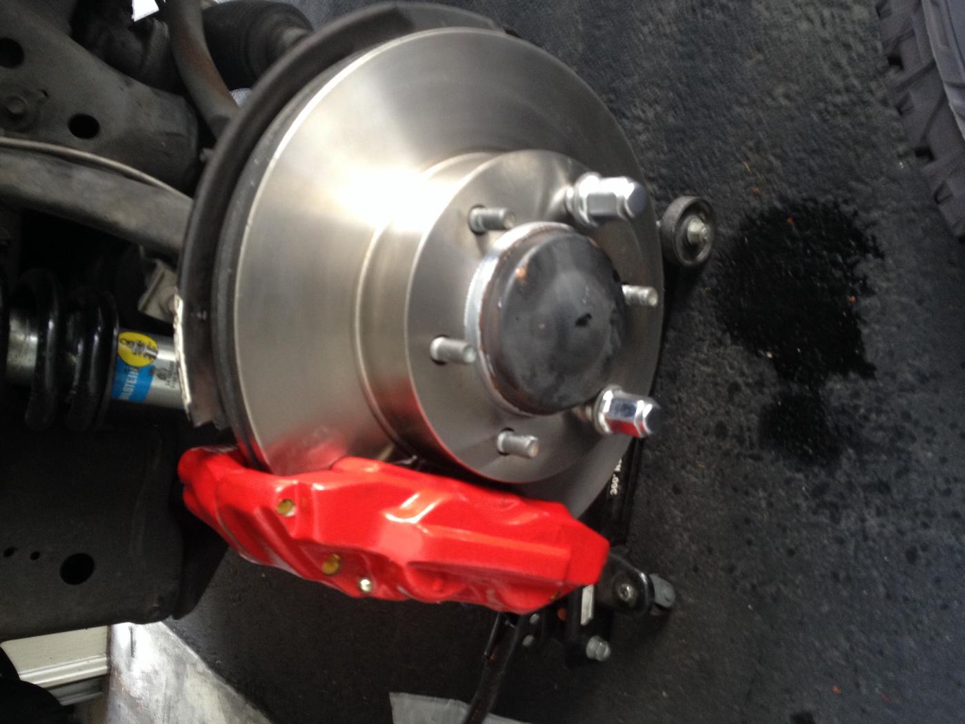

Did my brake mod this afternoon. Took 4.5 hours. Why did it take so long? I'm glad you asked...
Everything went well. I used the Powerstop calipers. I took my time, so all in, I was buttoned up and bled with mityvac vacuum brake bleeder. No problems. Got in the truck, pumped brakes, pedal to floor. WTF?
Passenger side had a huge puddle of brake fluid beneath. Spent a long time drying, inspecting, and generally getting angry. Finally, had my wife pump brakes, so I could see where the leak was. It was the new caliper itself. My lines were dry.
So, I guess I'm glad I still had the Callahans. Off with the Powerstop. On with the Callahan. No problems this time, other than, in a moment of frustrated stupidity, I put the Callahan on and torqued without the rotor in place...doh. Shrug. Took it off, put everything together as intended, bled the brakes again, and no puddles this time. I now have frankenbrakes, with powerstop on one side, and Callahan on the other. Glad they're the same color at least.
The brakes work great. Spent an hour driving around testing and bedding them in. No more shakes. Much better "feel" IMO. Super happy.
Bottom line: I can not recommend the Powerstop calipers. After another user posted a story about Powerstop caliper showing up with a missing O-ring, and given my experience, I don't think they understand quality control.
