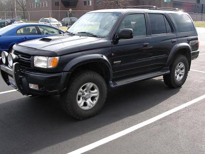

I just got my pp springs and bilstein's installed today. I need to take it back and get an alignment done. Here is what I think and my ride.....pics to follow tomorrow.
-For those who said the ride is rougher than stock I would disagree. My 4runner is stiffer yes, but in a good way and by that I mean, there is no exsessive body roll as before and hopping when I go over bumps. The rough roads soak up much better that before. I use to be able to feel rough roads throughout the whole vehicle now it is located to the wheels only.......if that makes sense.
-My runner is a 2002 sport 4x4 and I gained about 1 3/4" of lift, I'm sure when it settles it'll be about 1 1/2"
-I had 265/75/16 BFG A/T's installed about 5k ago and was rubbing at full left turn. I now have no rubbing issues although there is about 3/16" clearence when the wheel is turned and there is a chance they may rub again when the lift settles.
My 4runner looks like it should in my opinion....capable!
If anyone is thinking of this setup and has any questions please feel free to contact me.
Also....for those wondering I had them installed at Tire Discounters for $220.00 well worth it in my opinion.
-Adam

Took it in to get my alignment today and it's a lot better, however, before I took it in to get the springs/shocks installed I had no vibrations at all when driving 65-70. Now after the lift I get a vibration at 65-70, it's really annoying!!!
Any thoughts??? Could the almost 2" of lift have chanced the drive line enough to cause this? Should I be concerend?
Any help would be great!!!!
-Adam
The 4Runner looks great with the new setup, I really love the sport look.
Did the alignment shop check the balance on your tires also? I had a vibration problem until I finally found a decent shop that really knew how to balance large tires.
I didn't have the vibration until the springs/shocks where installed. The vibration isn't a constant vibrating, it comes and goes rythmicly......if that makes sense.

likely its a balance issue
try getting them balanced.

get the tires balanced. you should not have any problems.

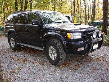

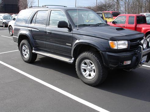

here is my rig with the pp1 and bilstiens. I also put on the addco sway bars same time absolutely love how it rides now. dont think you can get newpp1 springs anymore. someone correct me if im wrong.last pic is with stock tires (265/70R16) no rubbing new tires 265/70R17 some rubbing drivers side fender flare nothing a sawzall couldn't take care of to 10 seconds . you can only tell if you look real hard.
