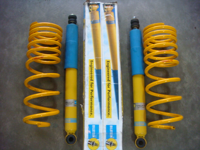

1" PP spring
I happen to have a decent set if you're interested.
