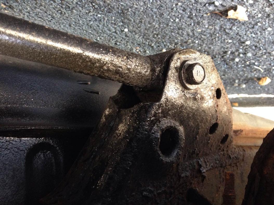

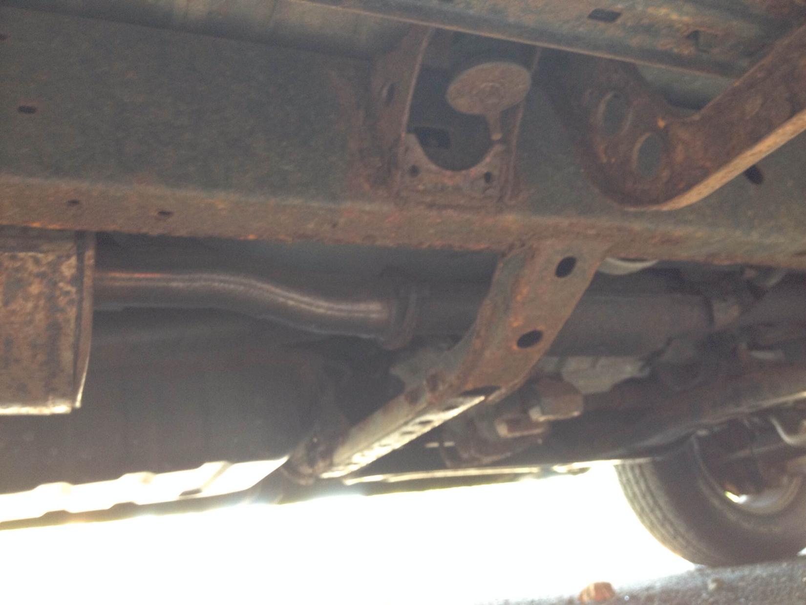

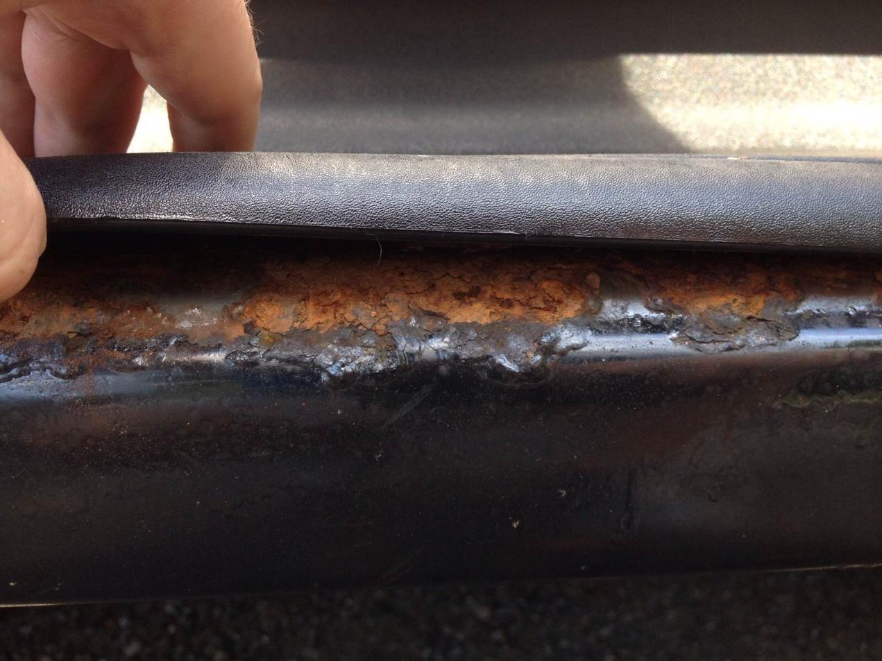

Hello all. Hoping to become a new member of the 3rd gen 4runner club -- and hoping perhaps to do it too cheaply. I need some advice on a 4runner that I have been considering. It has only 110k on the odometer but has spent its like in NJ, so there is rust.
I have attached some photos.
I have also looked up the service history and have found a couple of notable entries that give me cause for concern (below). I realize that I will need to spend some money on the truck (but would like to keep it under $1k in the short term -- and I am not too mechanically inclined, so that includes mechanic labor time), but I am not sure if I'm buying a money pit.
What do you all think -- is this a relatively good buy (for appx. $5k), or should I pass on this one, from a rust/rot perspective? Unfortunately (or fortunately), I need to make a decision on this one quickly at this point. Thanks for all the help, and sorry for the ignorance.

from the pictures it looks mostly like surface rust, which if it is, you can wire brush most of it off, spray on some nice degreaser, a good metal prep, and then paint with a nice sealant and no more rust. This is not a quick process though. I just did it to mine and my underbody looks brand new. But it took my almost 4 full days to do it right! If your handy it might be worth the buy. But I am just talking from a rust perspective. I would try to steel it away at 4k if you could. use the rust to your advantage. but if you are not mechanically inclined i either suggest you start reading and learning or steer away. and you are most likely going to put more than 1000 into this puppy
Thanks! You are not particularly concerned by recent need to replace the differential housing, brake backing plate, muffler, etc., apparently due to rust?
Do you think there is much more coming on this front in the near future?
I don't mind cleaning surface rust (whether myself or with help). I'm more concerned about a constant slew of drivetrain/mechanical issues due to rust.
I'd keep looking. Being from Texas (not the coast) we don't like rust at all. I'd take it for 3k maybe but I'd rather have a clean rust free unit.
I would avoid this one.. That first picture (not sure what it exactly is) does not look like surface and with that list of items - you are going to spend a lot of time and may find the rust is a killer. I would keep looking
Take a hammer and "tap" on the bottom of the frame rail right in front of the mount to the lower control arm on the rear axle (next to the muffler) Look on the inner portion of the frame also. Bet you find more rust then you'll be willing to deal with. I found my "hidden" rust a couple months later. Just got a welder to fix it this weekend however. My dif housing also leaks. It's holding now with JB weld while I try to find an axle housing.
