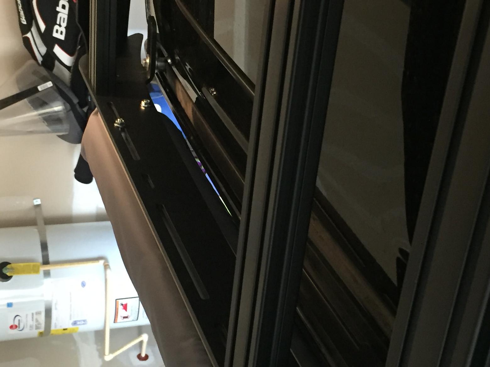

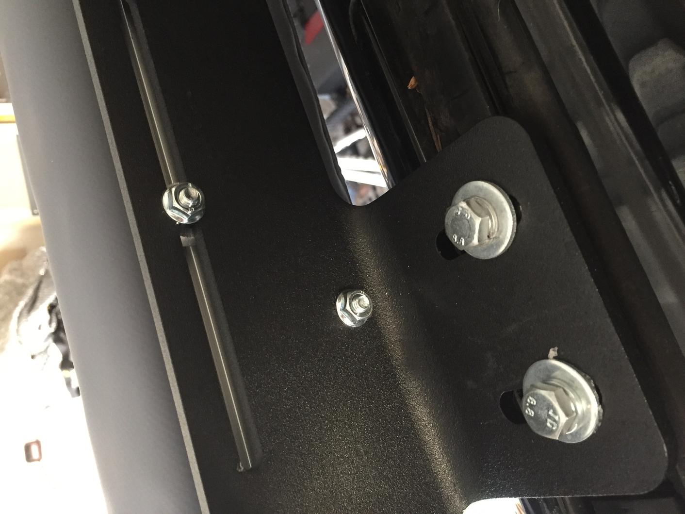

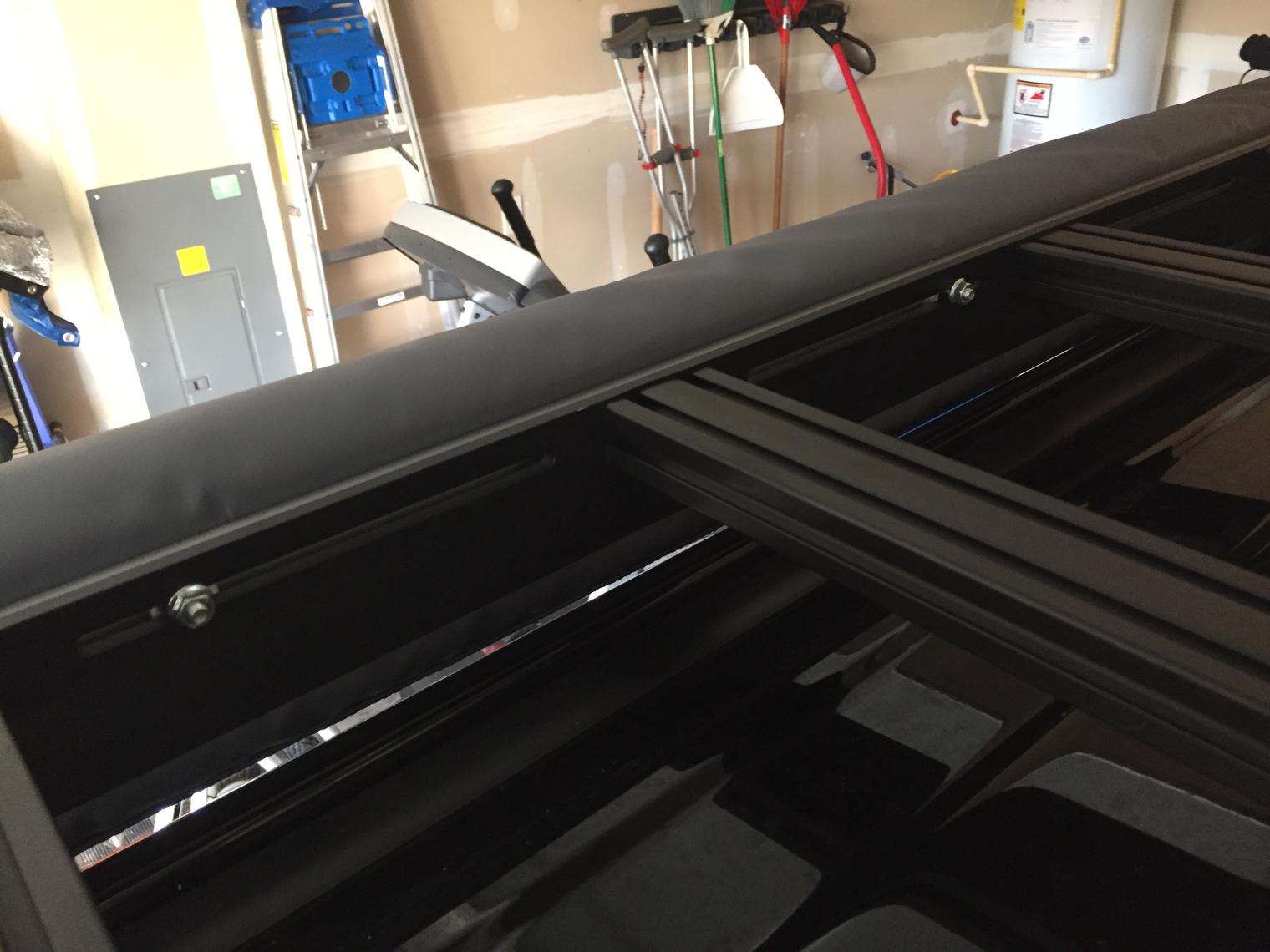

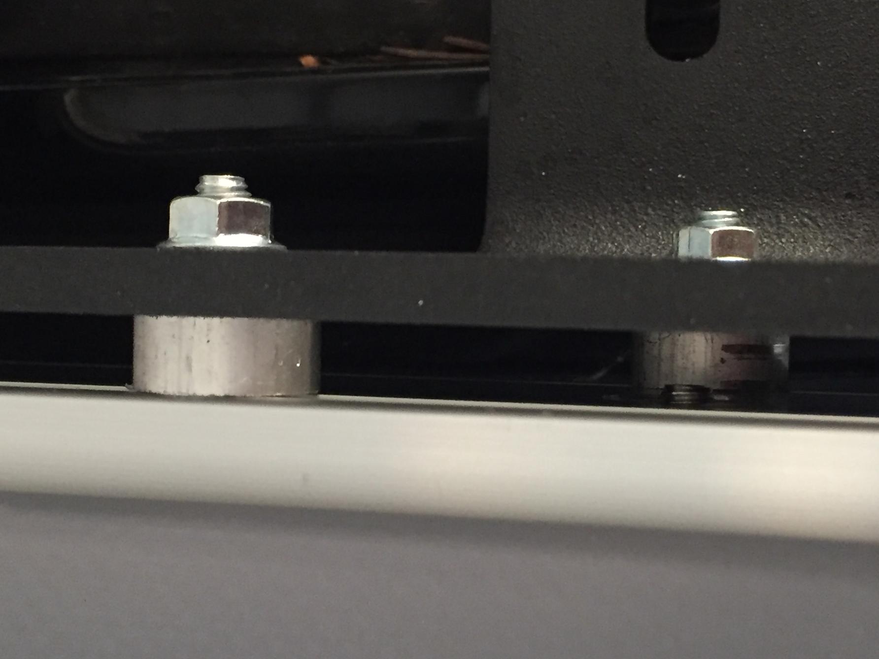

Yeah took it to Mule expedition to have them fabricate a mount for it. I did not want it to float high on the rack which is the only option available. They drilled two holes to secure the awning. The pictures show it best.
Nice, clean install. I was debating mounting my awning the same way but was concerned that the doors would hit the awning when you open them. I used some brackets similar to the ARB ones but don't like how it sits above the rack.
Does your door rub the awning when you open and close them?
Nope no rubbing! They did drill two additional holes to make the awning more secure, we looked at the L brackets, but I didnt like the look and the PRinsu awning bracket sits way high above too and I did not want that. One of my biggest reasons for getting a full rack was for the awning for shade at dog events, so I was okay drilling the two additional holes to make it more secure. They did a really good job and made it look clean.

Those look similar to the ARB L brackets, we tried those with the awning mount below coming off the top of the rack and it didn't give enough clearance for the awning without hitting the door, then if you reverse the L it sits way too high. The top of the crossbar to the side rail height is almost he same just a slight bit higher on the rail. The side rails height is 2.25" high.

No problem! Yeah flipping the L brackets works, but the door could not clear as the side rails were too short. I think the Tacoma racks have the lower second slots below too so essentially Mule just drilled them (2) not my rack to make it the same.
