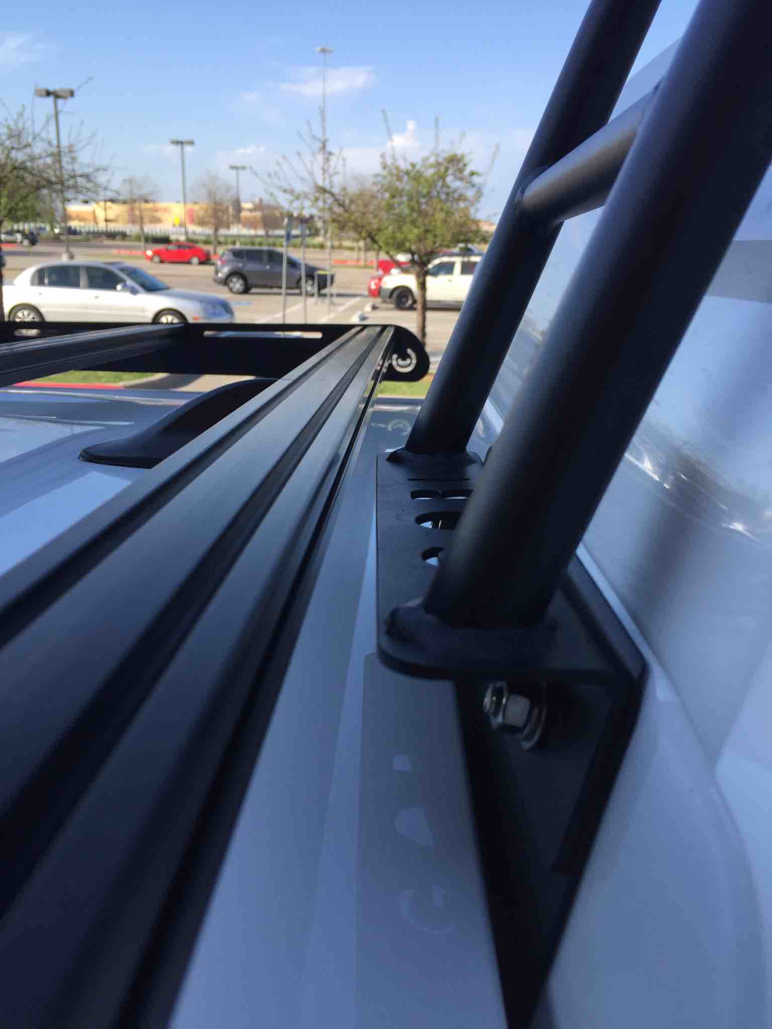

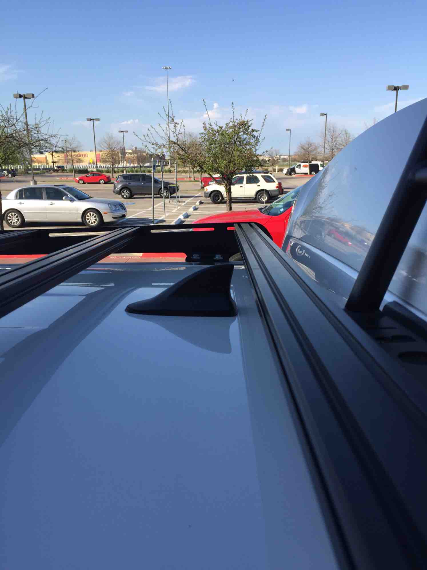

For those wondering how close it is with the antenna and gobi ladder
Looks like you have a good 1/2" from the rear bar to the shark fin. For whatever reason I can't fit the rear bar behind the antenna as it bumps. I mean I understand each vehicle and rack will have different tolerances but it would seem it still should have fit. I moved the bar in front of the antenna and will likely be getting the 1x1 bar he has for the Tacoma to fit in the rear
Pretty sure the 2016 antennas are bigger, causing the interference you are having.
I also have a 2016 but haven't installed my rack yet. Thinking I may just notch that rear bar if the interference isn't too much. I was half heartedly looking for a lower profile replacement the sharkfin, too
