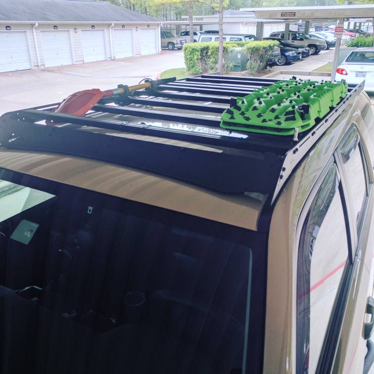

Side note, got my TRED Pro's and Krazy Beaver shovel mounted up this weekend
Sent from my Nexus 6P using Tapatalk
I got in contact with him through email. Really like the TREDs mount how did you get them up there drilling through the crossbars with the locking pins?
I purchased a set of the Maxtrax mounting pins (4) since they were $50, compared to $60 for a (2) pin mounting bracket from TRED. Then I picked up a piece of aluminum 1.25"x1.25" right angle channel. The piece I picked up was 1/8" thick, which ended up being too thin for the mounting pins' threaded studs, causing the lock nuts to bottom out before tightening down and preventing rotation. (3) washers for each pin fixed the problem, so either get a thicker piece of right angle or grab some extra washers. You can get some 1/4" carriage bolts or 1/4" t-nuts, similar to how the front fairing attaches to the rack. My only concern, is that I think the TRED Pro's are either thicker or don't nestle as tightly as the Maxtraxs do, so it doesn't look like I'll be able to fit a full second set (4 TRED's total) like you can with Maxtraxs.
