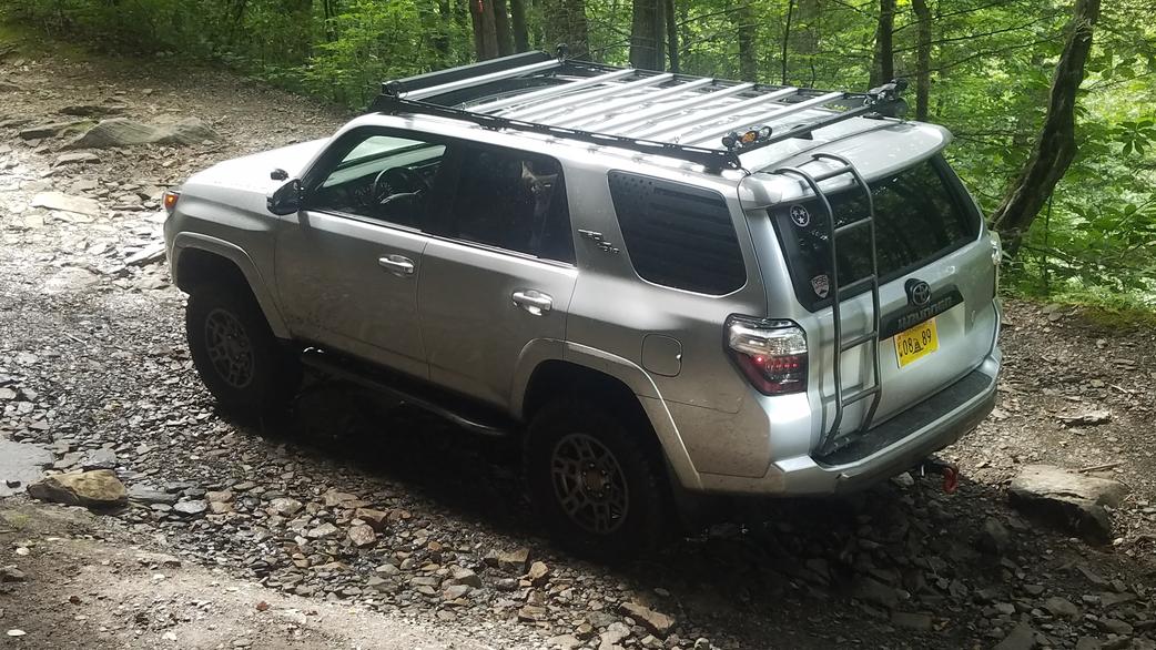

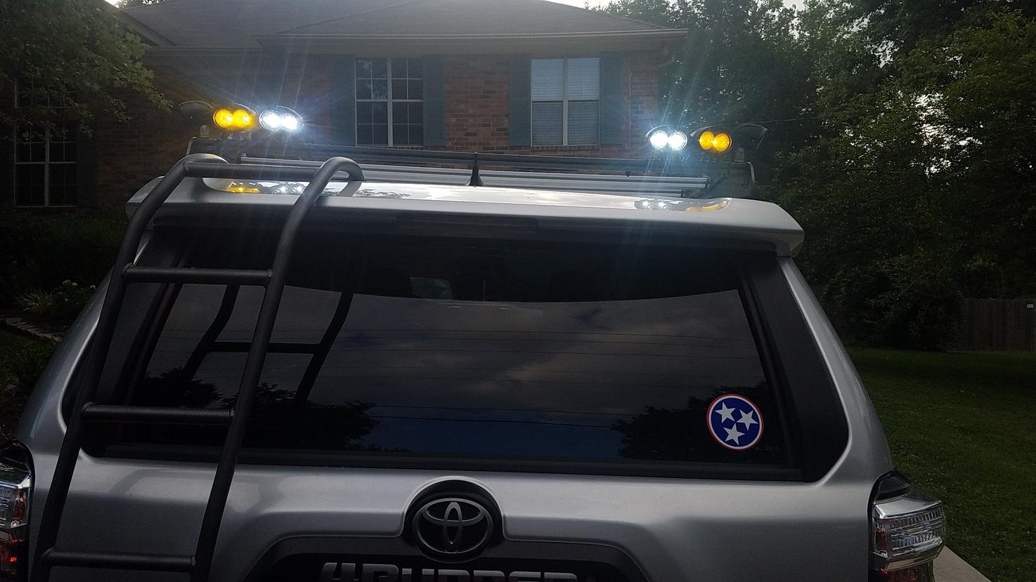

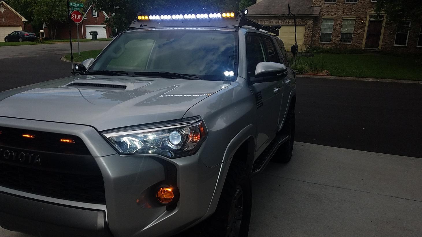

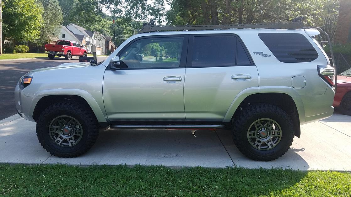

I went Prinsu. Had one on my Tacoma and loved it. I got my full length in bare aluminum shipped for $750 which was a pretty good deal. I painted it after I got it. I did drill for the front mounts because I wanted to make sure it was sturdy. I left the single bar out over the sunroof. I just ordered some poultry pen flooring to attach as decking on the rack. It should arrive tomorrow and I'll install it when I get time. Here are a few pictures.
