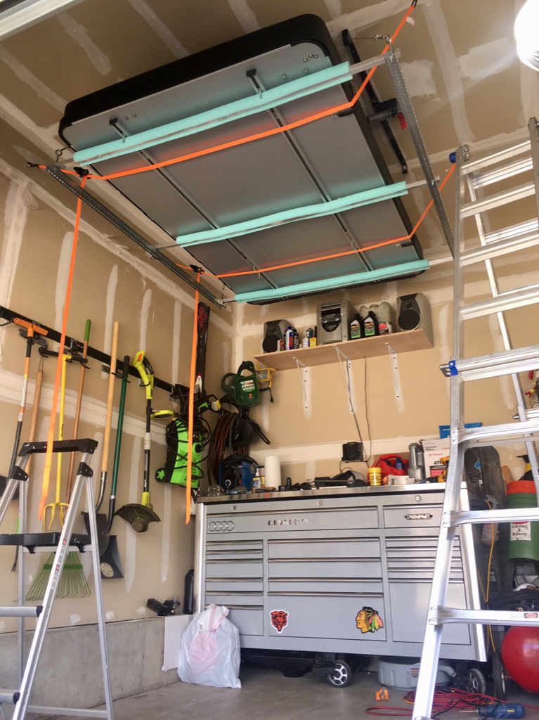

The iKamper has support rails, I set it down directly on the rack. Here’s the underside now that I have it off for ski season.
