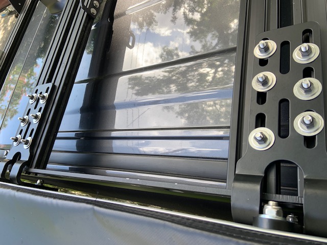

No rooftop tent, but I just mounted the OVS 180 awning to my Sherpa rack. The mounting brackets are beefy but the take up some space on the crossbars. My advice would be to use six 1/4-20 carriage bolts, one inch fender washers, and standard washers on each bracket. Doing this will require two crossbars per bracket, otherwise you will only be able to line up three bolts per bracket rather than six.
As a result you may lose some flexibility with your crossbar placement unless you add a few extra crossbars.

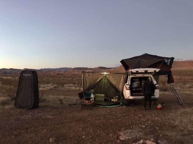

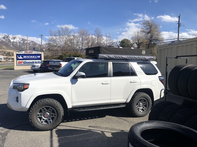

I’ve been running the Arb flat rack with their awning mounts. We’ve got an Arb 2000x2500 awning with room and an IKamper x-cover on it. Perfect size for both of them and no noise or issues having them both up there.
