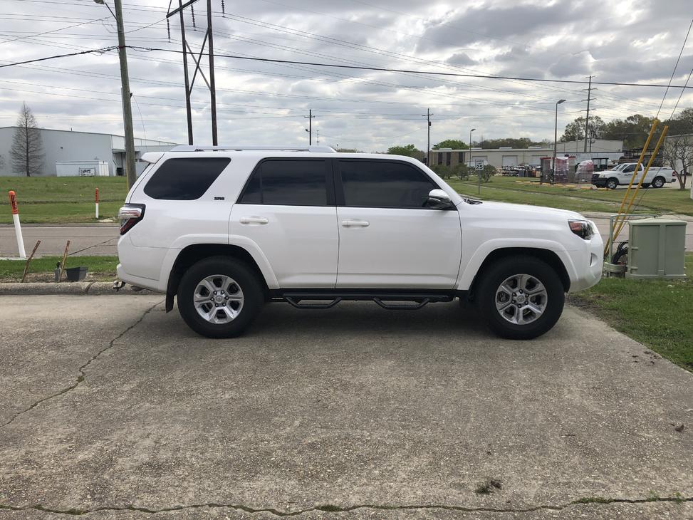

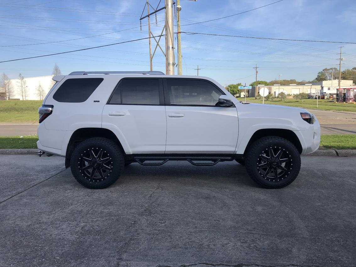

Got the install done today and the extra parts were not needed. Everything went together perfectly with stock parts. Here is the before and after.
