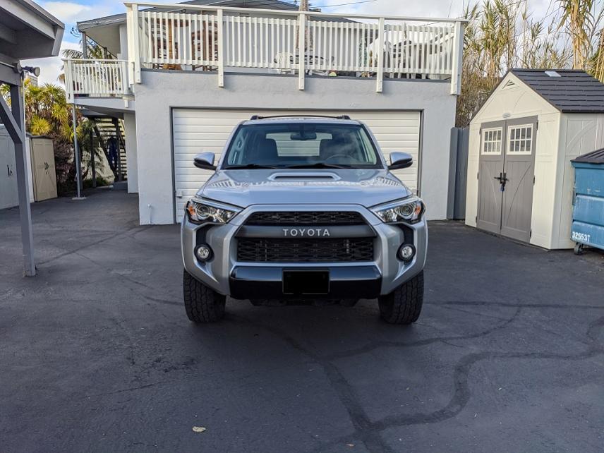

2nd I installed a new set of TRD fox shocks on my Trail Premium with KDSS today (looks and feels amazing). Measurements before and after;
Before center hub up
19.5 Front L/R
21.85 Rear LR
After
20.50 Front right
21.00 Front Left
22.50 Rear left
21.75 Rear Right
Update: Ride quality fantastic. I seem to have .5 lean on both front and rear. I will try the equalization procedure, but most likely sticking a .5 inch spacer in the front
Update 2: install shop did the equalization procedure after install, so you'll definitely want a .5 spacer in front and rear passenger side, if you want perfection. I might hold off on doing this as it's not really noticeable.

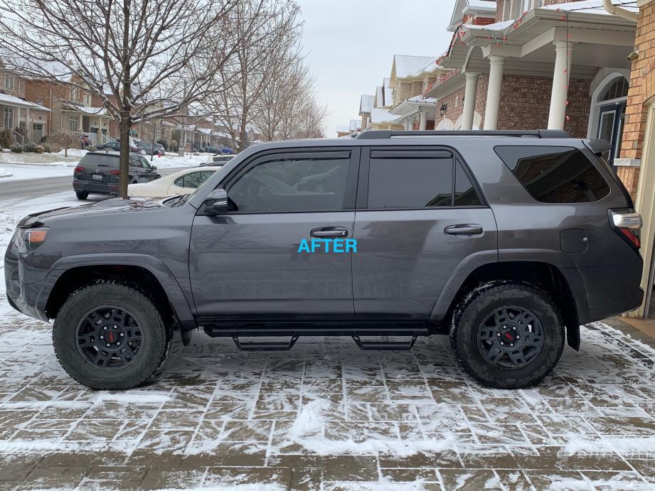

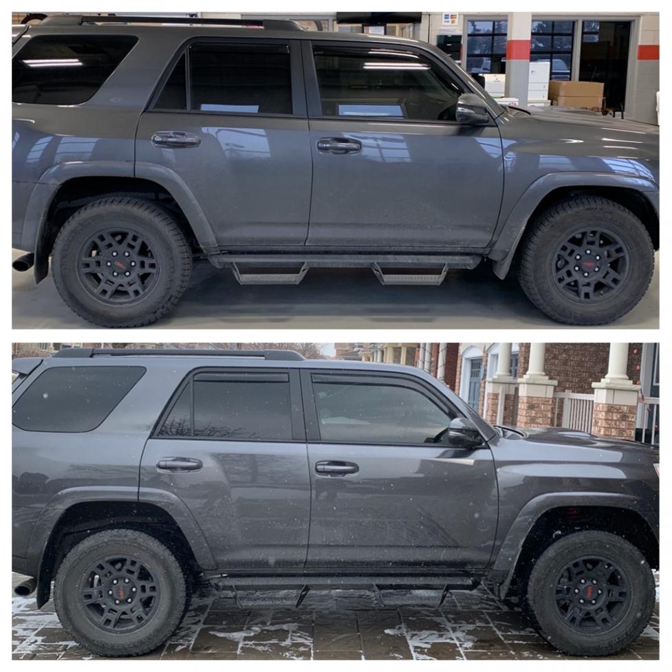

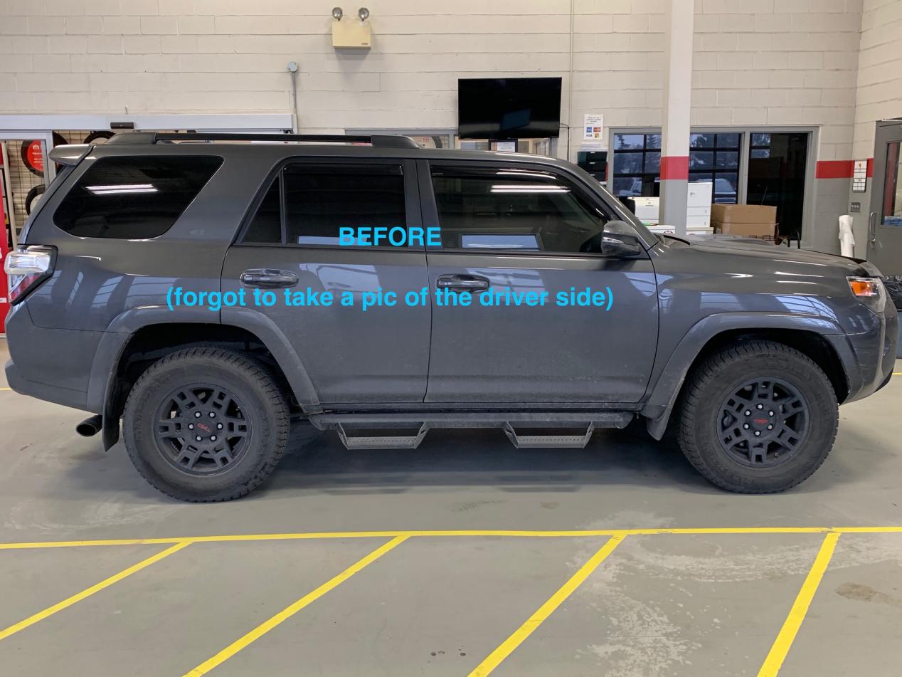

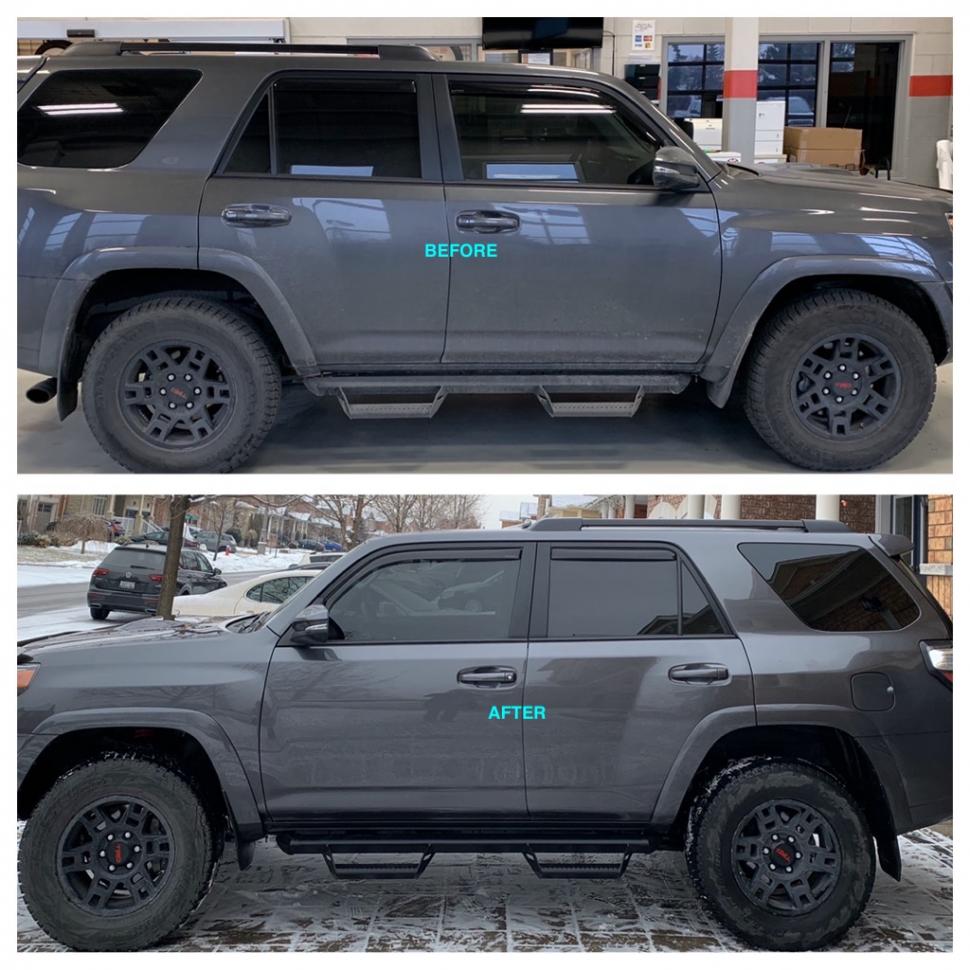

job of installing a Full TRD Fox Suspensions front and rear successfully completed today on my 3 months old 2020 TRD-OffRoad with KDSS. NO cornfed 3/4 spacer although bought, NO rear spacers. Also used rear coils that came with the TRD Fox.

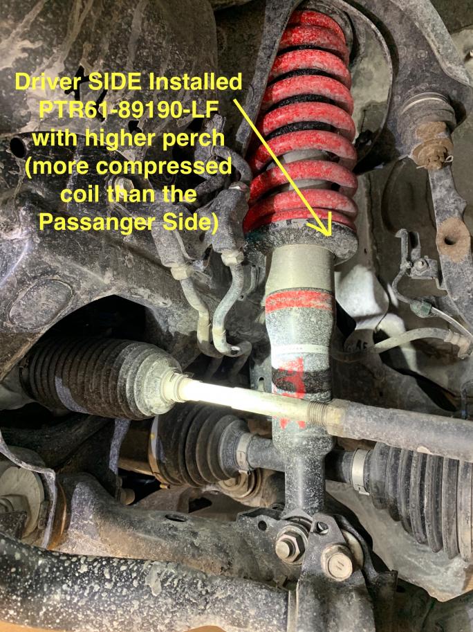

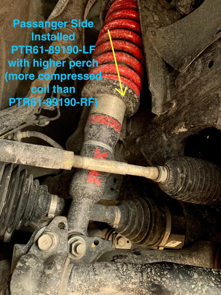

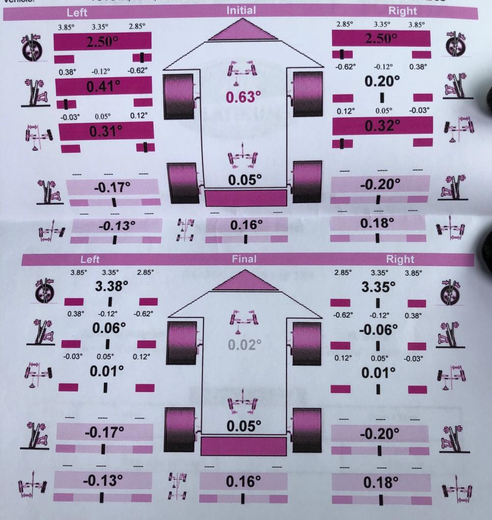

installed TWO driver side TRD Pro Fox suspensions on both the Passenger and Driver Side. I actually had this install done at a dealer to keep the warranty intact but the service man FLIPPED the front sway bar for whatever reason - he said it was coming in the way of the oil filter. Today I corrected everything and FLIPPED BACK the sway bar and everything installed perfectly. Scott Fisher @Aiden James gave me some tips and confirmed that the KDSS Swaybar in its original position should not cause any issues. so at home today, I completed the project using with ratchet straps to ensure the the KDSS cylinder doesn't expand all the way while flipping the sway bar.
anyway, the most positive result i want to share with you all is that the 4R with KDSS is 100% levelled in all sides. ABSOLUTELY ZERO lean issue after the install. Wheel Center to Fender measures 21.5 inch both FRONT Driver and Passenger Side, and 22.5 inch for REAR Driver and Passenger Side. Ground to Front Fender on both sides is approx 35.75 to 36 inches and the rear is 36.80 to 37 inches on both sides. Alignment measurements are in the pic.

I am not running identical front shocks. I am using the complete set that comes with a taller (more compressed) Driver side shock which is about .5 inch taller than the passenger side shock.
