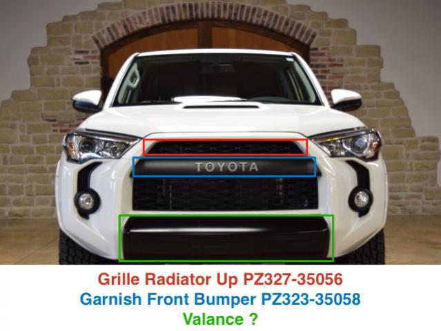

I am looking at changing the look of my 2020 TRD ORP by giving it the Pro look. Can you guys verify the two parts below and let me know what the part numbers are for the front and rear valances? Also, any recommended sites to purchase these at a decent price would be appreciated as well.
1. The Garnish Front Bumper PZ323-35058 is the actual TOYOTA bar? (see picture below)
2. The Grille Radiator Up PZ327-35056 is the replacement grill above the TOYOTA bar. (see picture below)
3. What is the part number for the front valence?
4. While I am at it :). What is the part number for the rear valence?

Thanks! And You're welcome. I did all four of those parts in about 2 hours. Including piddling with YouTube videos. Make sure you're careful with the corners and edges on this panels. Might want to swing by a dealer and grab some touch up. Never bad to have on hand either way.

I did. They say it's possible to do front without, but I don't fit into tight spaces very easily. And taking it off isn't that hard.

They say it's possible to do front valance without removing the bumper.
I replaced the front lower valance (replaced silver with black) yesterday without removing the bumper. It wasn't too bad, and only took about an hour. The key was to remove the plastic cover where a skid plate would go underneath, then I was able to reach all of the clips and remove them with the bumper in place. It also helped to have the new Valance on-hand so I could see where the clips are on it, and count them. Made it alot easier to blindly feel around and remove those clips.
I'll be replacing the back valance this week, which after researching alot looks like it'll require bumper removal. Wish me luck. I'm a little nervous about taking the whole bumper off a new vehicle but I'm doing it because I don't like the look of the silver valance on my all blacked out 4Runner.
