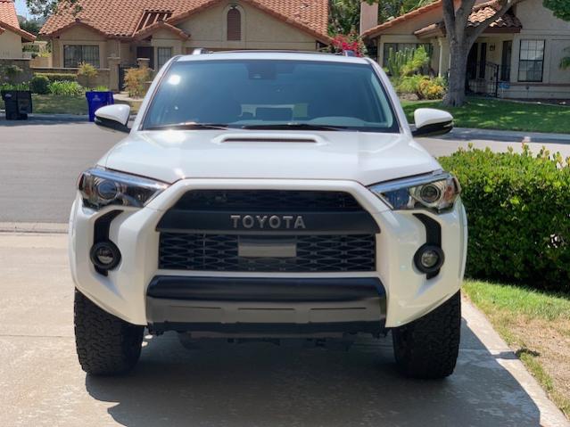

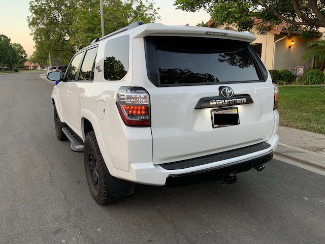

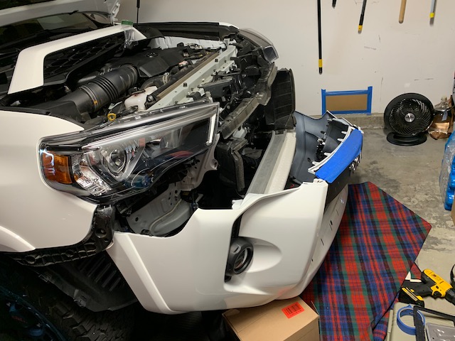

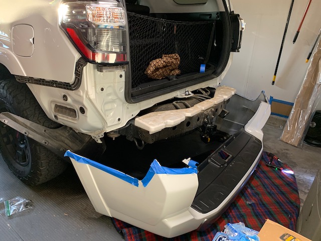

Hey Noy,
Sorry I missed this post, insanely busy at work. The garnish and upper grill were pretty easy. The valance was kind of a pain in the butt, not too bad but a pain. Check out the during and after pictures below.
Sorry again for the delay
Colt

Hey Noy,
Colt
Looks great, rare bumper seems like a B***H to take out. Im gonna go for it see what happens...
