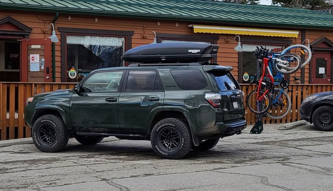

That is exactly my setup... was planning on going full Eibach, but didnt want to wait till September. Worth mentioning, I only used the lower Westcott perch as I felt it would give me the ride height I wanted. Rear is a littlw lower due to weight.. ski gear up top and two bikes plus rack on the back.
My tires are 285/65/18 and fit stock, but also different offset wheels.
No complaints what so ever.

Wow, great looking rig! So if you out the top plate in, how would it sit?

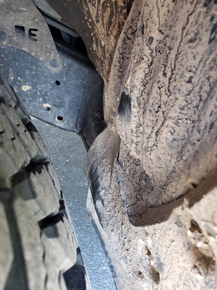

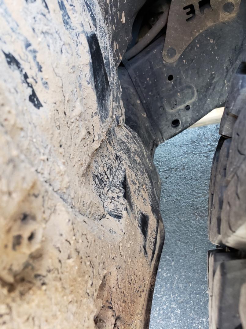

You can run the 285s with the pro ins stock trim...thats what I did. Slight rubs fixed with a heat gun. I am waiting on the eibach springs too and this worked for me. Its fine until they get in. Off road only minor rub on steep downhill left turns. Minor enough that I have not bothered to address.

Have not done a full articulation test. But after install of 285s I did spend a week in New Mexico mountains on some pretty rough terrain...from NM CO border to roswell.

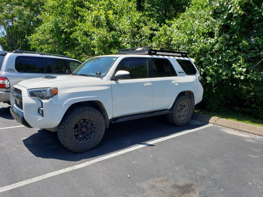

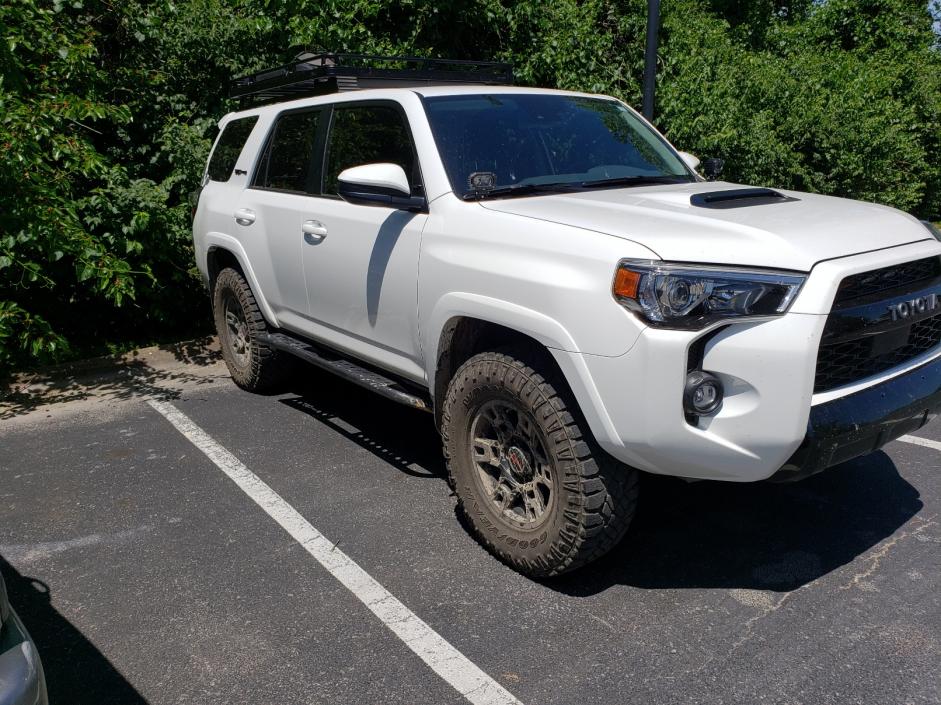

Did not have any issues. But since you asked I just took a look at my truck and took some pics for you. Keep in mind that I have the 285 70 duratacs which measure a full 33 od according to manufacturer. From what I can see it looks like the heat gun mod may have bounced back a bit. I drive pretty aggressive and don't slow down much for driveway transitons, speed bumps etc. As far as pushing wheel travel I have definitely pushed it...the kids like hitting transitions fast. Anyways, it looks like the rear of each well, the liner has sprung back a bit, maybe I did not get hot enough. You can see the obvious clean spots.. mine is a 20 model with the TSB fronts,, so the same as a 21. There is no rub on the front of wheel well. Hope this helps.
