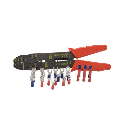

Just get the proper size ring terminal for the wire and the stud or bolt you are mounting it to and use a crimp tool to assure a good connection.

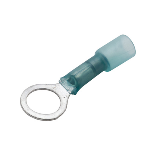

Ha-ha-ha, we all had to start some place:lol: This isn't rocket science here, you can do it! No need to solder provided you use a quality crimp tool, and quality terminals. For exterior connections, they make crimp terminals that have heat shrink already attached. Simple, strip wire, crimp connector to wire, pull on connector to insure tight connection, heat heat shrink with heat gun or lighter until it shrinks down and adheres to wire, you now have a waterproof connection :reddance:
