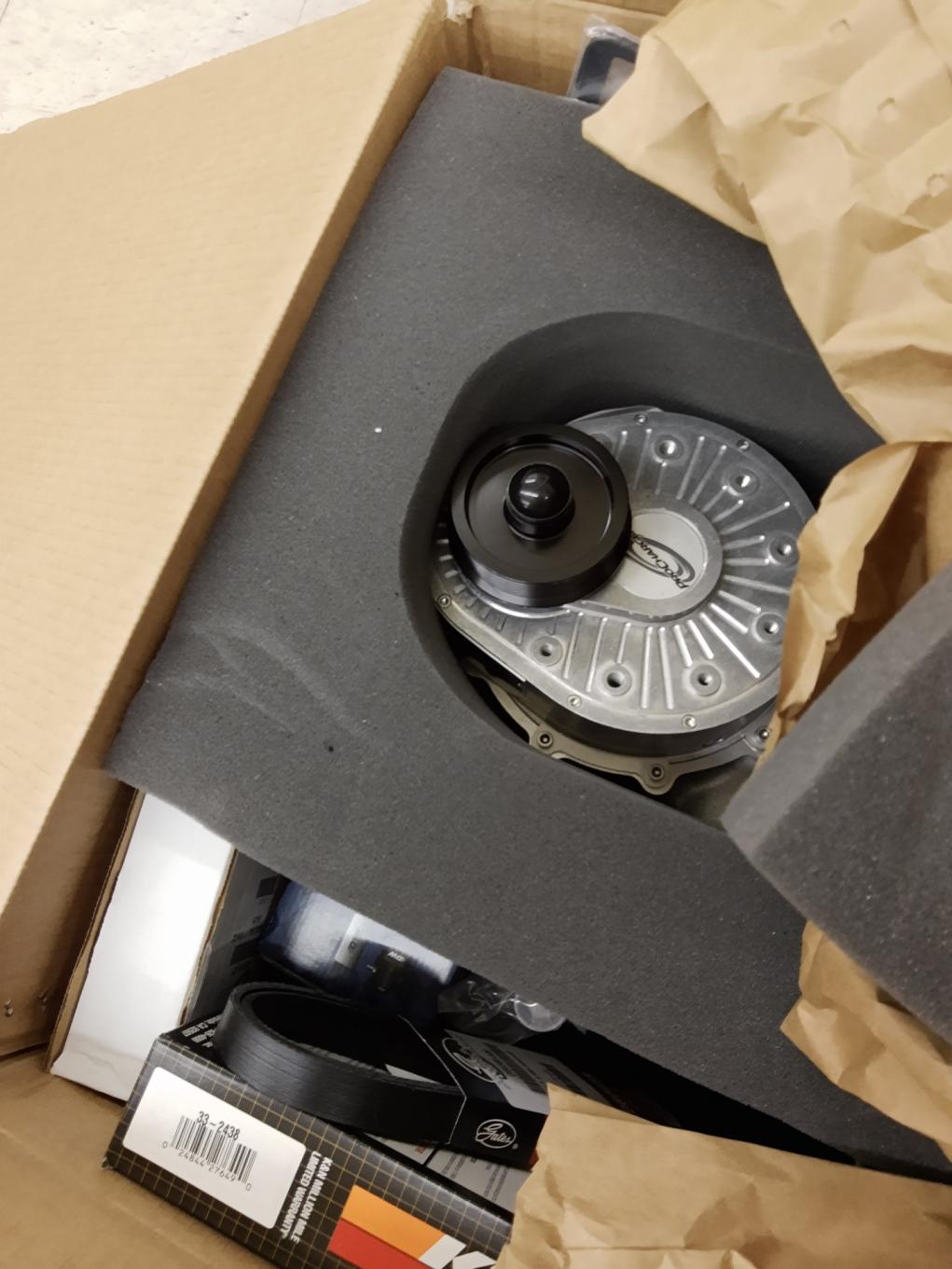

It's happening
Parts have arrived, I'm dropping it off tonight and I'll pick it back up in a few days.

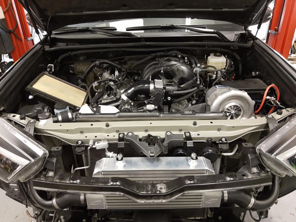

How it's coming
They are almost done with the install and then it needs to be tuned. The intercooler is too big to have my behind the grill light mounted at the same time so that had to go, but otherwise everything seems to be fitting just swell. That supercharger is actually as big as it looks in the picture, it's pretty wild.
