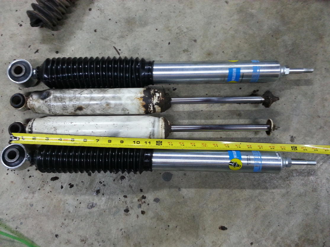

ProComp 1.5yrs vs new Bilsteins. The ProComps got beat up and the threads broken off during removal but the shocks themselves were blown within a year. And the Bilseins not only last longer because they're built better but they ride much nicer. Worth the $ every time. I got mine from Toytec along with their Superflex coils.

Also the ones that you bought were probably the proper length for a stock height rig. You will need shocks that are longer for the 3" lift.
PS. the front shocks are all the same length (within a small amount), lifted or stock height. This keeps the front wheels from drooping too far and allowing the CVs to pull apart from over-extension.
Being as the Bilstein 5100s are a Monotube shock, they have much larger pistons, and more dampening ability.
