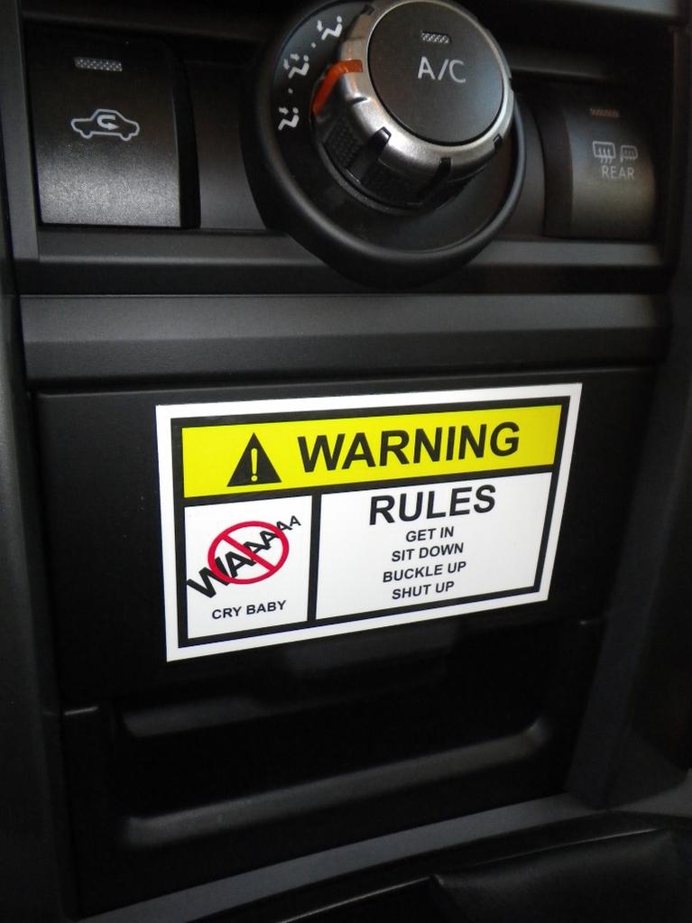

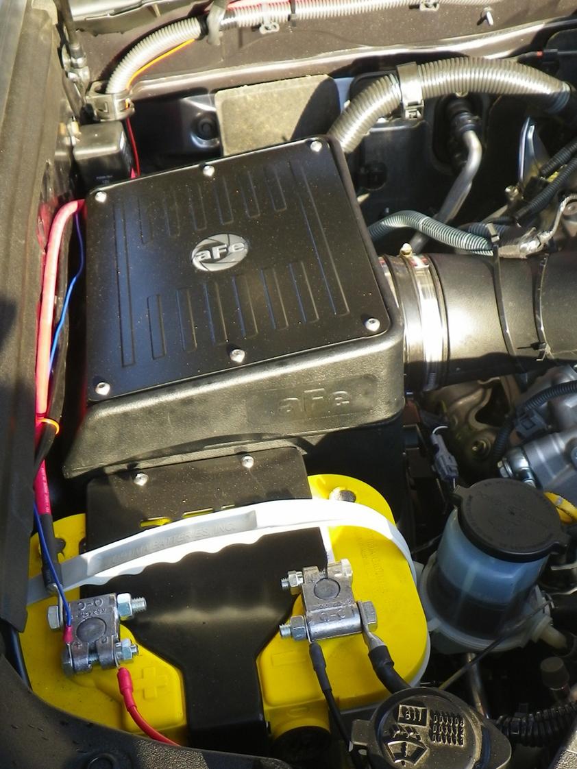

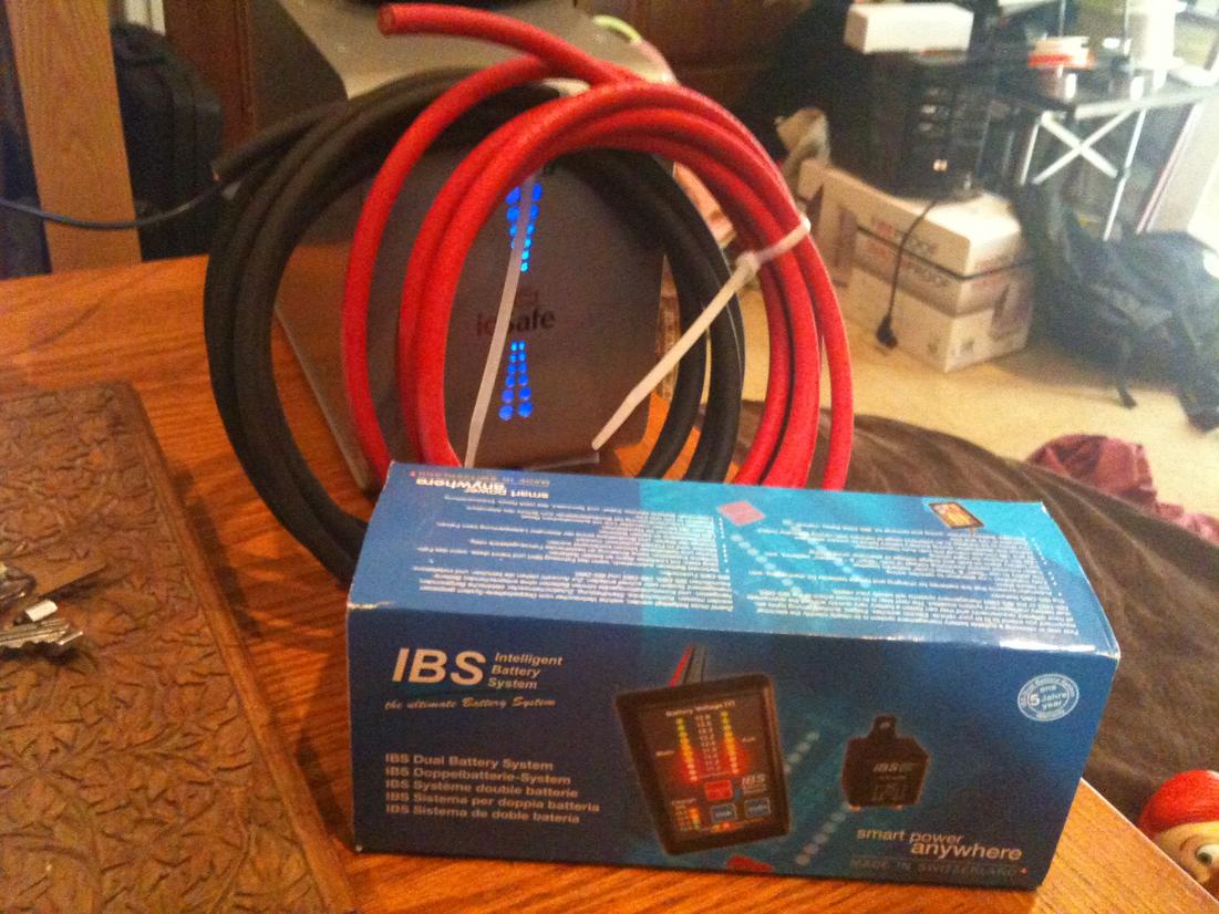

the pictures attached show proof of my accomplishments. First you see the IBS box and the included 4 gauge wire. The next shot shows the Optima yellow top battery installed in front of my aFe cold air intake in a Blue Torch Fab tray. The IBS isolator is installed on the side wall behind the aFe and is linked to the controller I currently have sitting loose in the glovebox. The last pic is a mounted sticker that reflects my general attitude.

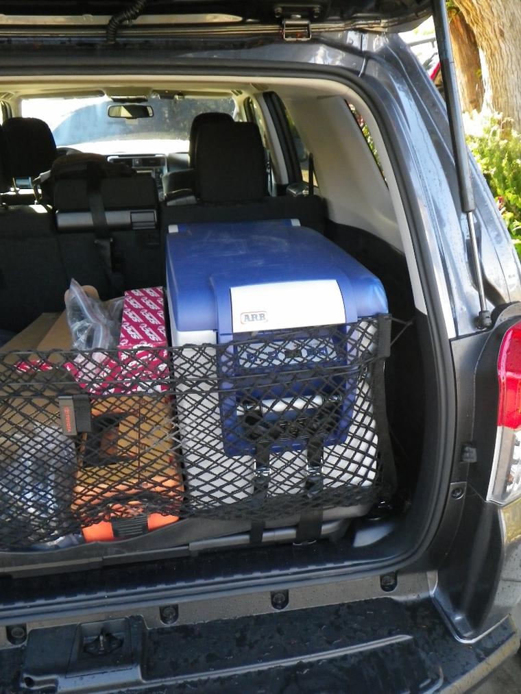

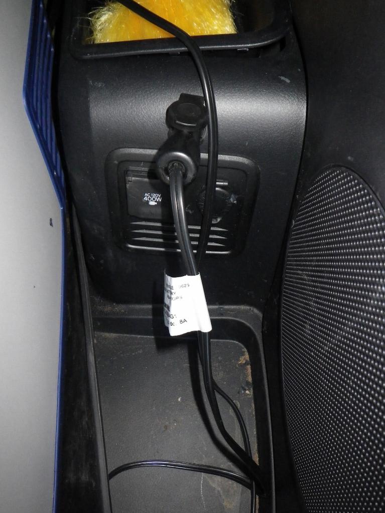

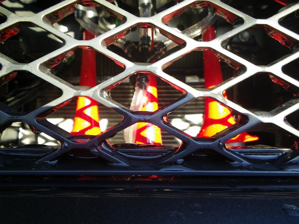

More proof for you demanding basturds (Note to moderator--it isn't a bad word and I spelled it wrong anyway :biggrin2:). The first pic shows the Hella Triple Tone air horns where the original horns used to be behind the grill--I'm not pulling it apart for a better picture. I had to make a basic bracket to install this, but it was no big deal. The pump is mounted to the side using an existing hole and I wired it by plugging into the existing harness. The second picture shows the ARB power receptacle (I think it is a Powerlet socket) installed above the factory receptacles. I ran it from the battery through the passenger side under my Husky floor mats to the rear where I drilled two small holes to install it. The last picture is the fridge mounted on the sliding tray on top of my Husky bedliner and attached at the front with the ARB fridge mounts--I didn't drill anything--I just used the existing attachment points at the edge of the tray.

Nice mods. Did you have to relocate the p/s fluid and AC with your blue torch fab box? Or was it able to squeeze in on the side there? I've had the IBS system sitting around for a few months now, trying to figure out a good layout for the second battery.
