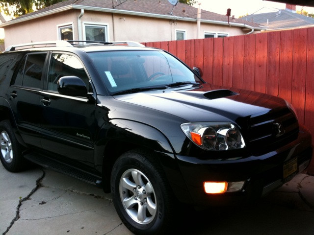

I've just joined the 4runner club, found a great 2005 sport edition and I'm loving it!! :bluejump:
Unfortunately it only came with a single key + fob. I order a key fob and a blank key off of ebay. Programmed the key fob with no trouble. However, I haven't had any luck programming the key transponder. The key is cut to match and turns the cylinder OK. The problem is I see a lot of conflicting instructions on the internet. I've tried most of them with no luck.
Has anyone successfully programmed a new key for their 4runner?
Thanks in advance!
