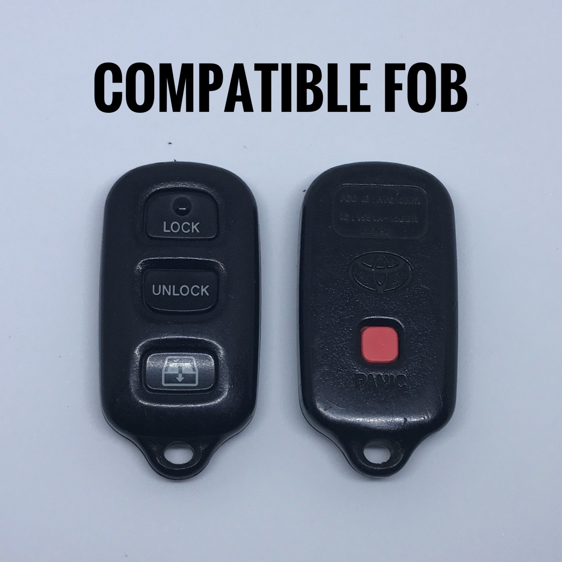

I bought these aftermarket key fobs from Amazon:
Amazon.com: KeylessOption Keyless Entry Remote Control Car Key Fob Replacement for HYQ12BAN, HYQ12BBX, HYQ1512Y (Pack of 2): Automotive
I followed the programming instructions posted above and here:
2002 Toyota 4Runner Keyless Entry Remote Fob Programming Instructions
As mentioned above, I needed to use my hand to "help" the driver's side unlock. I also had to turn the key in the ignition 5 times at 4C. After the locks locked and unlocked a few times on their own, I then repeated the process, turning the key to ON and back off 2 times. Programmed two fobs and they work from at least 30 feet.

Thanks for the suggestion to go with OEM. I purchased an OEM fob of off eBay and got it programmed on the first try with no issues. The button for the rear window is is even working perfectly!

My '99 is the same as yours (no box under the seat and no alarm light on the left side of the dash). What worked for me was ordering a fob from here, FCC ID: HYQ12BBX (that part is important since there are a few different remotes that look the same with different FCC ids). Then I followed the programming instructions in this thread, but I had to help the door locks up and down by pulling up when I unlocked and pushing down when I locked. The old motors get really slow really quickly when you lock and unlock in rapid sequence.
The remote you need is most likely the same one I got, but you can always use a vin lookup website (I like this one) or call a local dealer's parts department to confirm. Just don't believe them when they tell you they need to program it for you.
