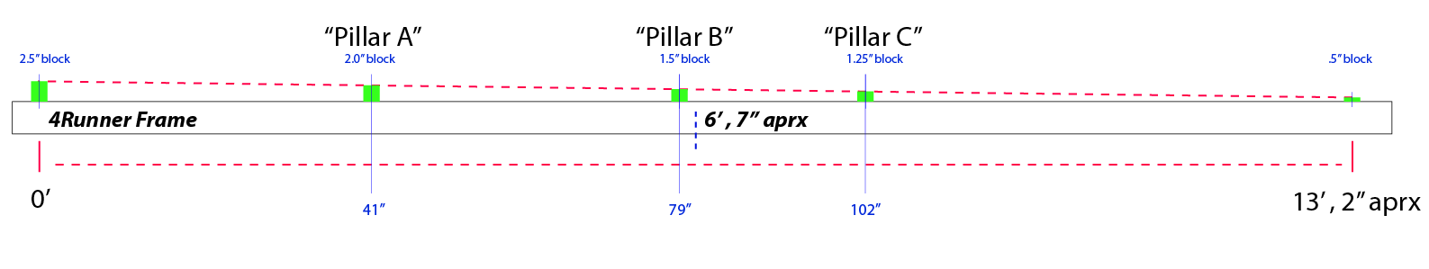

I didn't like the -neg rake in the front end.
I wanted to do a body lift, but I didn't need a lift all the way around.
I did some research and found a chevy suburban owner that didn't want a leveling kit for his truck because it would still not level properly.

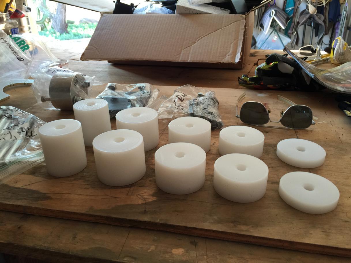

So I contacted Roger at 4crawler.com and asked if he had ever done one. He said he had done a couple....
I told him what I wanted...

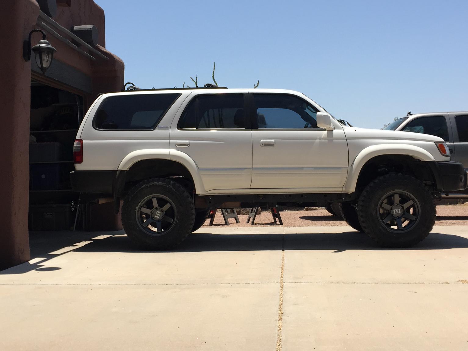

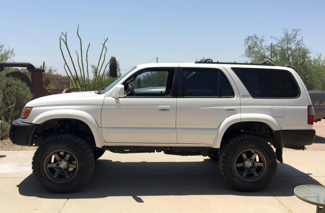

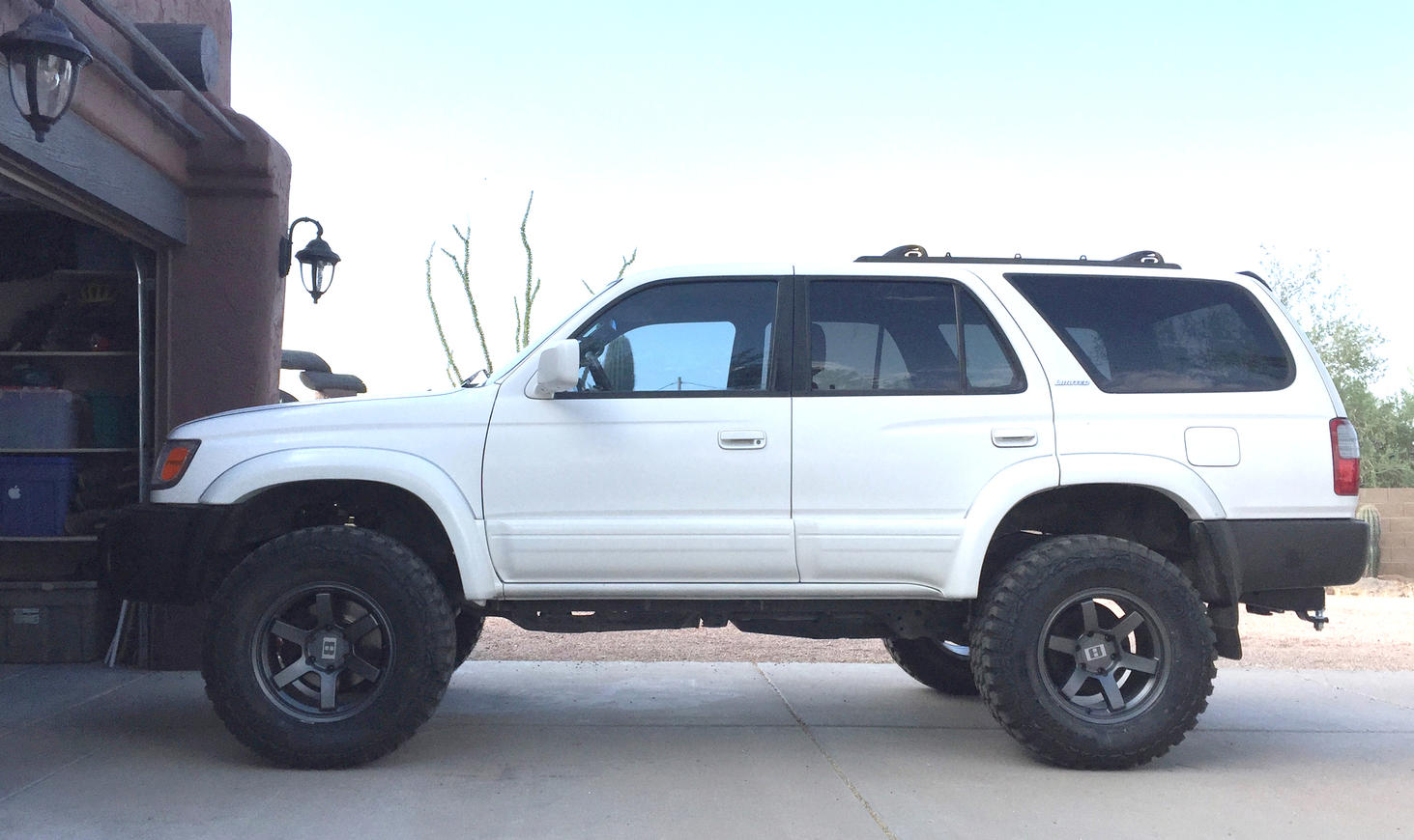

Roger puts together a quality product. Everything worked as it was supposed to and the end results were exactly what I had envisioned and wanted.
Spot on, and KUDOS Roger for going the extra mile for my lift.
