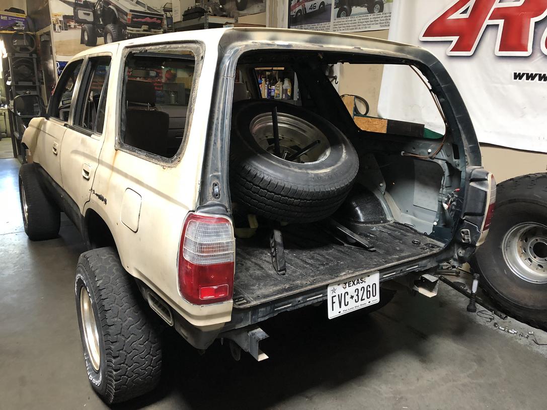

If I add any weight it will be for a spare tire carrier. I’ve had this new warrior tire carrier laying around for 3 years. Should look pretty good back there when I chop the top

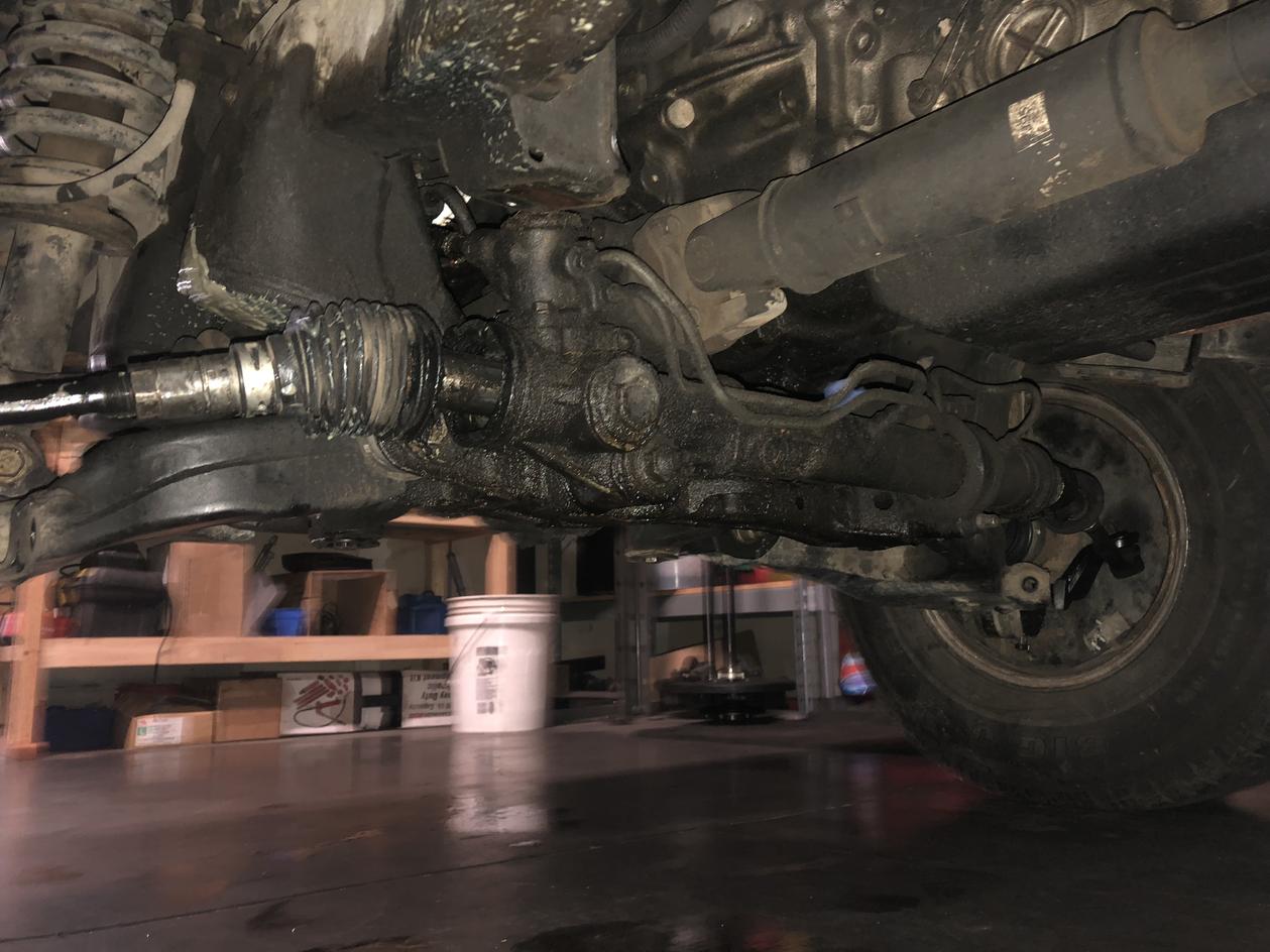

Today’s fix was swapping out the power steering rack with a new one. First was to pressure wash the underneath as it was covered in oil. On top of the valve covers pouring someone ran power steering fluid instead of atf so the rack was leaking everywhere.

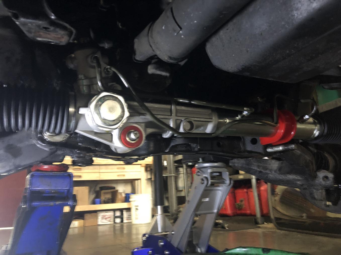

Since pretty much all generic after market bushings leave the rack with excessive play I went ahead and got some energy suspension bushings for $20 shipped. Normally I would not trust or install anything but a Toyota OEM rack. However I am in a contest with myself to see how cheap I can build this so I found possibly the cheapest reman rack on eBay at $130 shipped. It has a 2 year warranty incase of anything major but this truck really just has to make it down the road and trails and that’s it. Treated it with Toyota ATF I had on the shelf and almost ready for alignment.
Although energy suspension is usually known for making good products the rack still has more play than it should. So next is to insulate the bushings to tighten it up some then off to alignment.

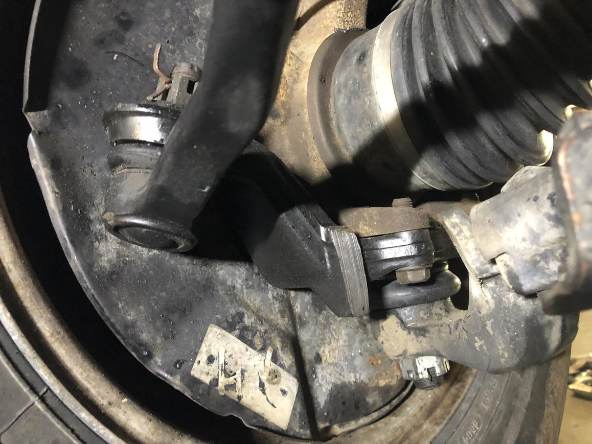

Couple weeks ago I took care of the most important thing you can do to a 3rd gen, lower ball joints. Since these are notorious for chunking ball joints I wasn’t going to settle for anything less than Toyota’s. I could have got the Japanese Sankei 555 lowers for $160 but I was impatient. My Sankei order from low range got back ordered so I got them same day my cost for $225 otd at Toyota. Worth every bit for the peace of mind.

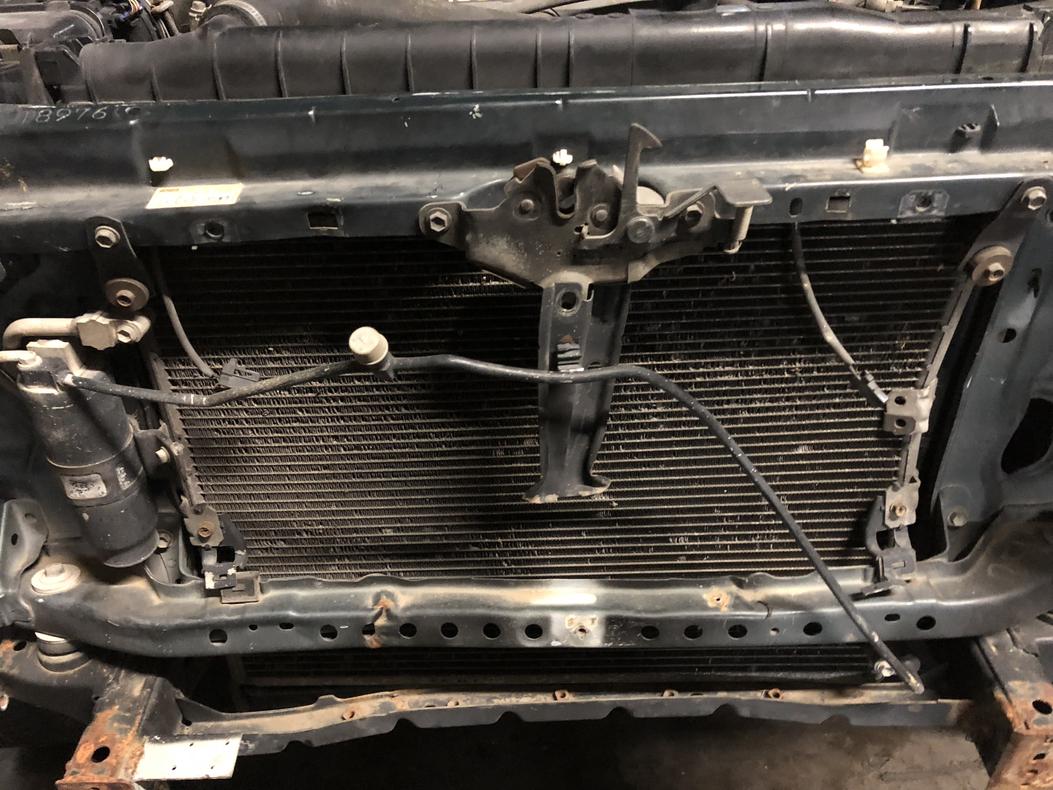

Another thing that was causing noise and just super irritating was the hood not closing right. The support for the hood latch was cut in half and the passenger stop pad was gone. The hood would not open, close or ride down the road properly. I had to tug on the core support to get the lower mount where I could bolt onto it again. With the support bracket in place and a stop pad under the hood it now opens and closes properly. No more rattle when shutting it or going down the road. Got the front plate on as well so front turn signals and it will be fully legal.

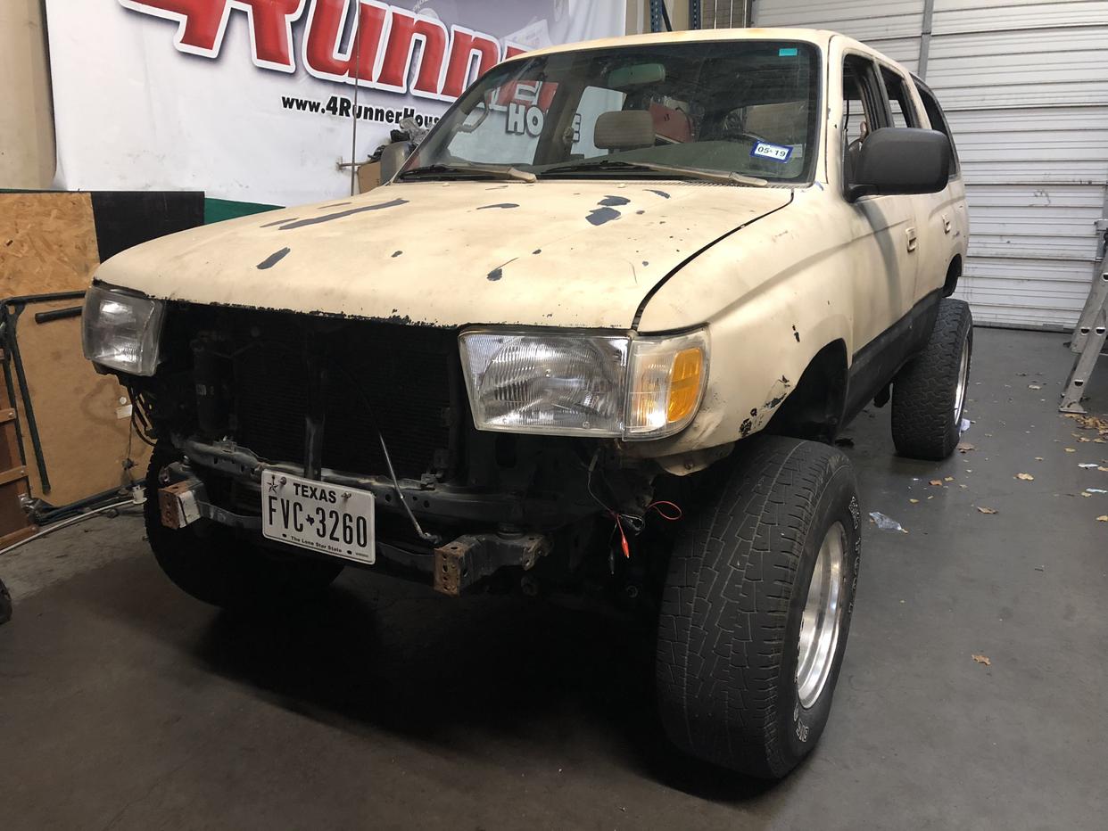

I had to whip up some turn signals in 10 mins so I could take her to get lunch yesterday. I pulled these clears off a 2nd gen and had no intention of putting them on anything else. Not proud here but hey it’s fully road legal now LOL

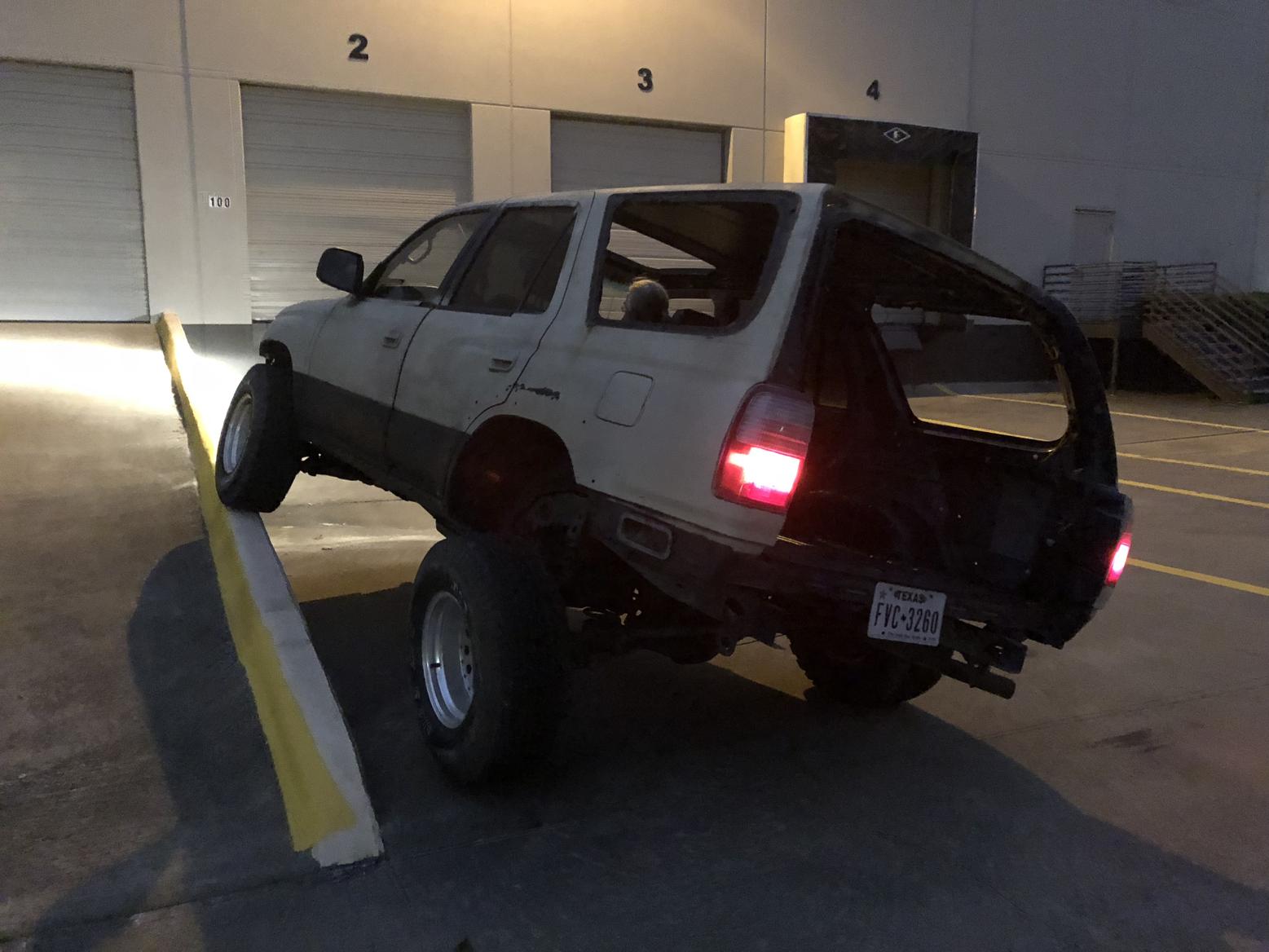

All road ready since getting it aligned yesterday. Took her through a muddy ditch crossing to test out the locker and did a little flex test. Need to whip up some license plate lights now.

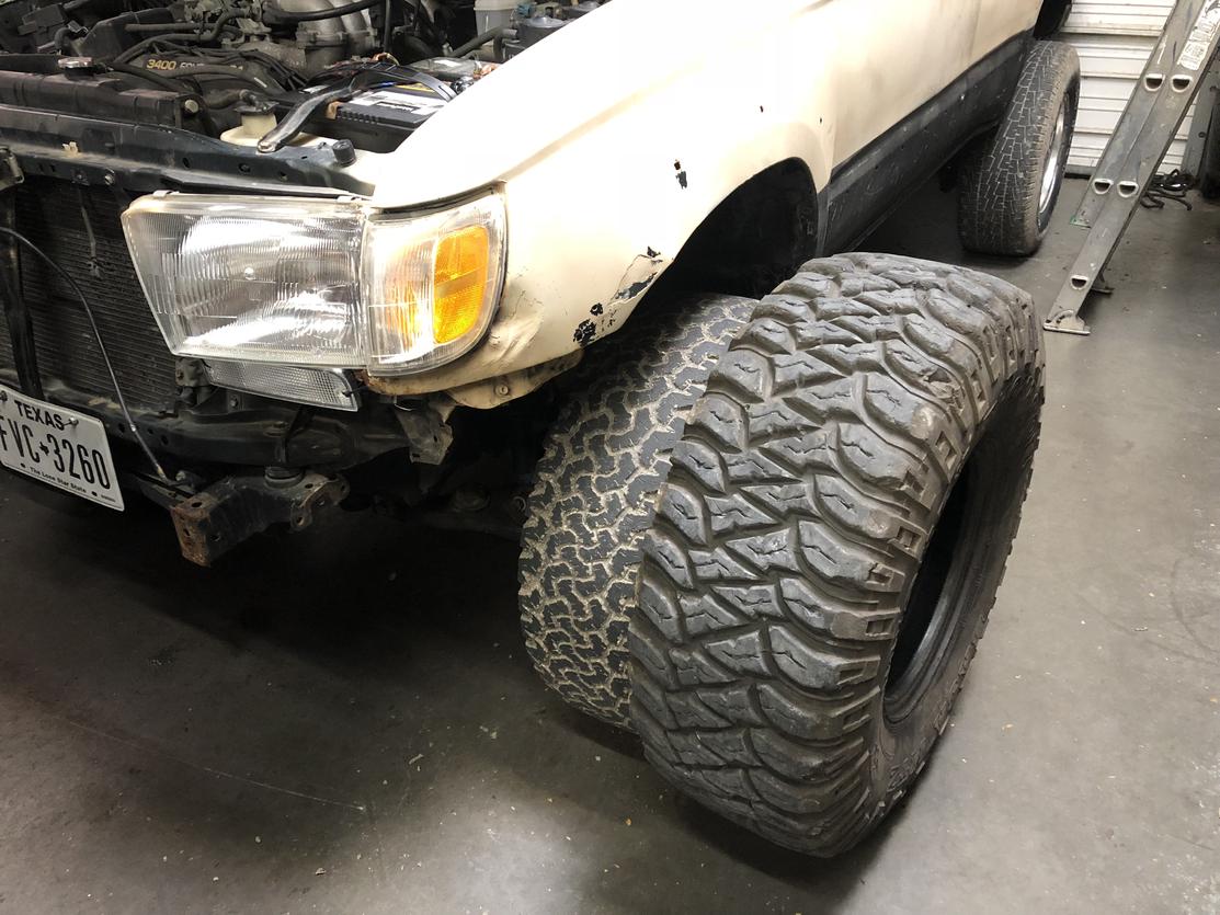

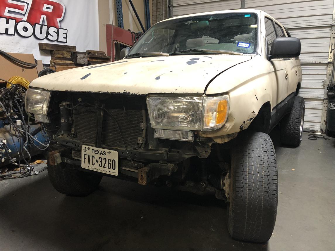

These 35” MTZ’s should help out in the traction department. Scored them for $200 with near full tread just have a good bit of rock rash. Perfect for this truck

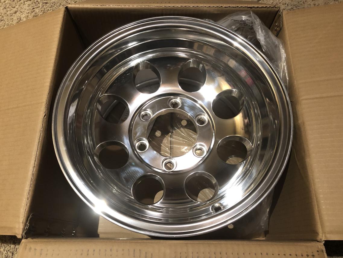

$296 shipped for the brand new pro comp 69 series 15x8 polished wheels. Looks like I’m at $1070 so far but totally worth it. Will be taking the truck out next week end to test it on some trails.
