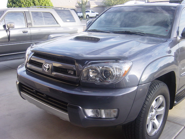

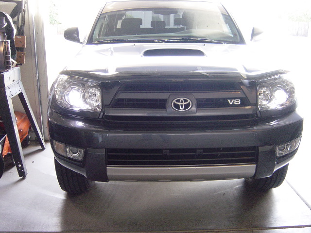

Did you have to paint the under piece of the headlight to match the color of your 4runner. How much?
Gotta get rid of the gap between the bottom trim pieces and the corners of the grille...
Other than that, I really like the look...Please share the details.

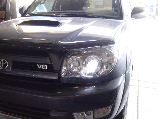

Doesn't look too bad the way it is, turned out nice. Would like to see a better pic of the piece under the headlight.
What about the DRLs, do you have an upper set and a lower set? Actually that might look pretty cool.

could you list the part numbers for the headlights and the under garnish. prices and where you got them from, i cant seem to find them at partznet, they dont list 4r in the 06 year yet.
8113035440 - head light
8117035420 - head light
9008081041 - Quantity (2) - bulb (side light)
9098113075 - Quantity (2) - bulb head light
9098115012 - Quantity (2) - bulb head light
8112535440 - Wiring loom for turn signals (use your old ones in conjunction).
That should be it. Sorry I don't know which is left and right or low and high beams... but that's the entire list w/o the body panel on the bottom. don't know that one off hand.
good luck
viper4evr2001 said:
goodtimes just making sure the part #'s that you typed for the headlight is for the 06' projector headlight??
YEs it's for the 06. you just need everything I listed plus the body panel number that I can't find right now.
