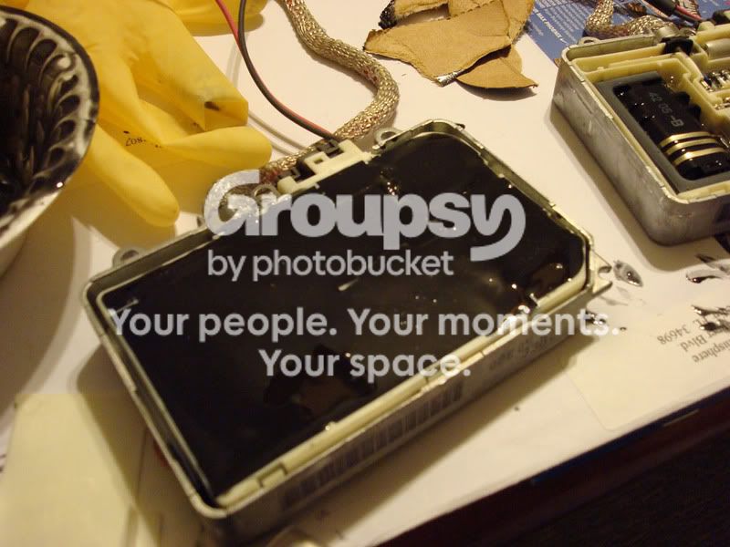

You could also fill the Densos with epoxy potting compound to totally waterproof them...

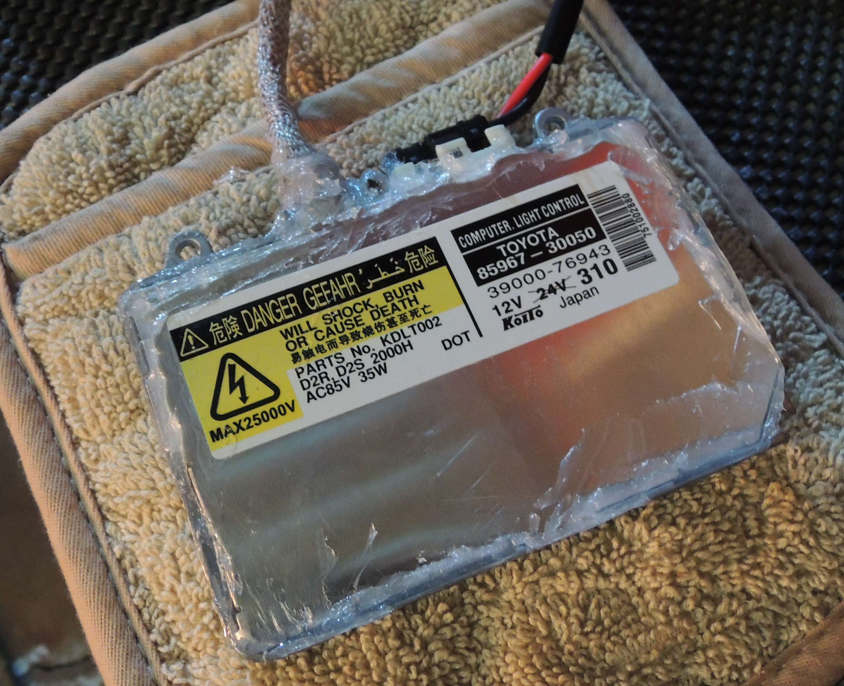

Denso are holding up just fine. On my wife's car I have the Morimoto ballasts. One set failed after 2.5 years and now that replacement set is acting up again.
I simply sealed the Denso up with basic silicone and would do so again.
