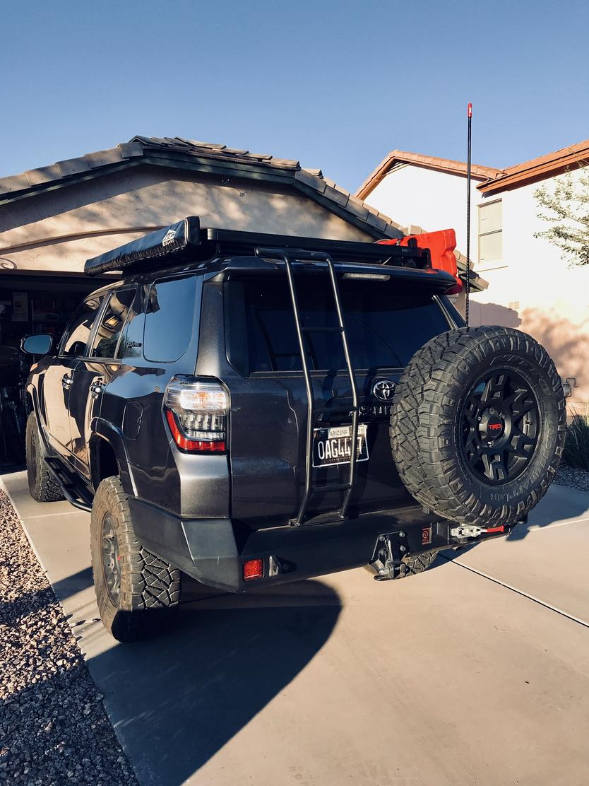

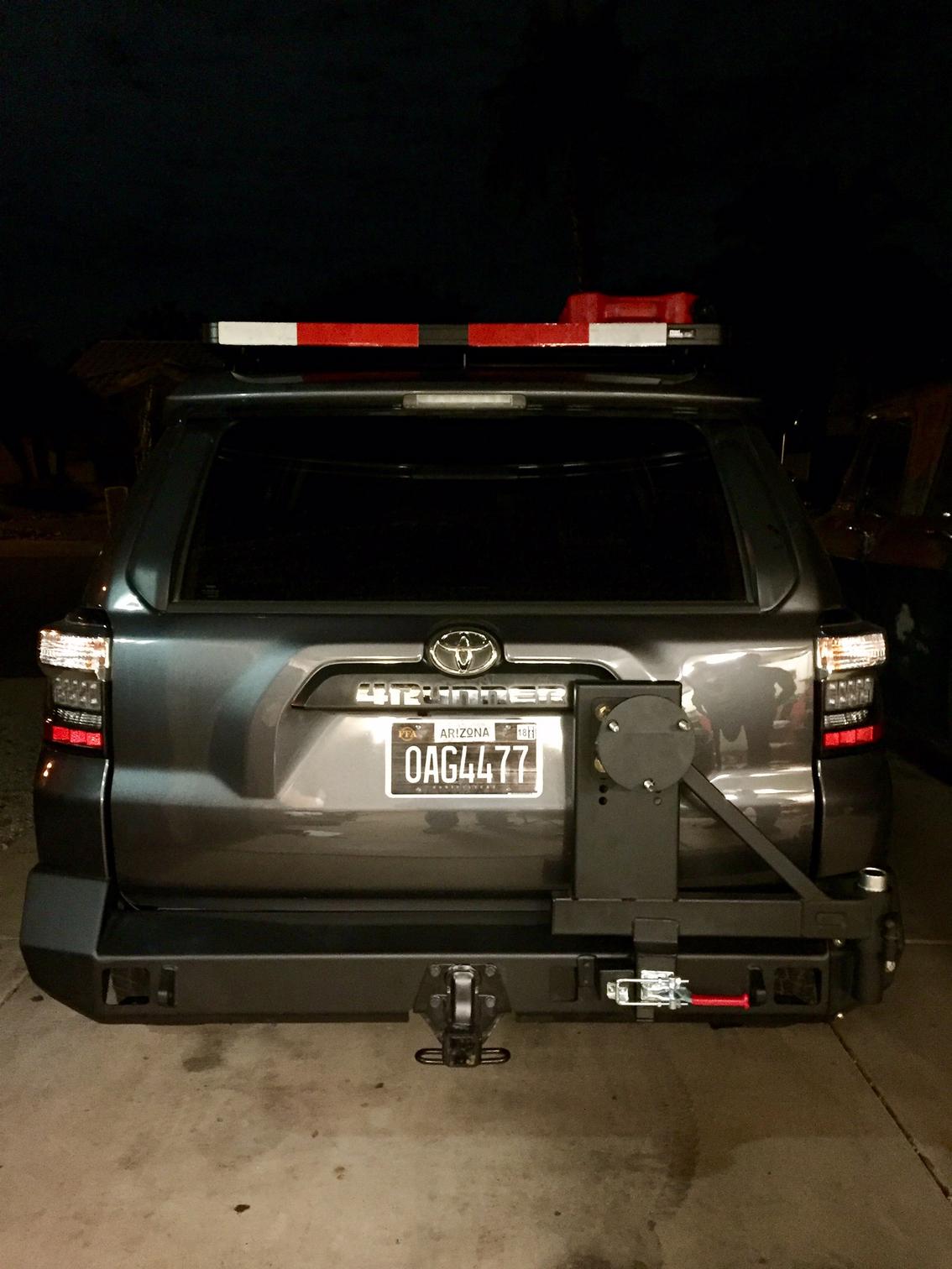

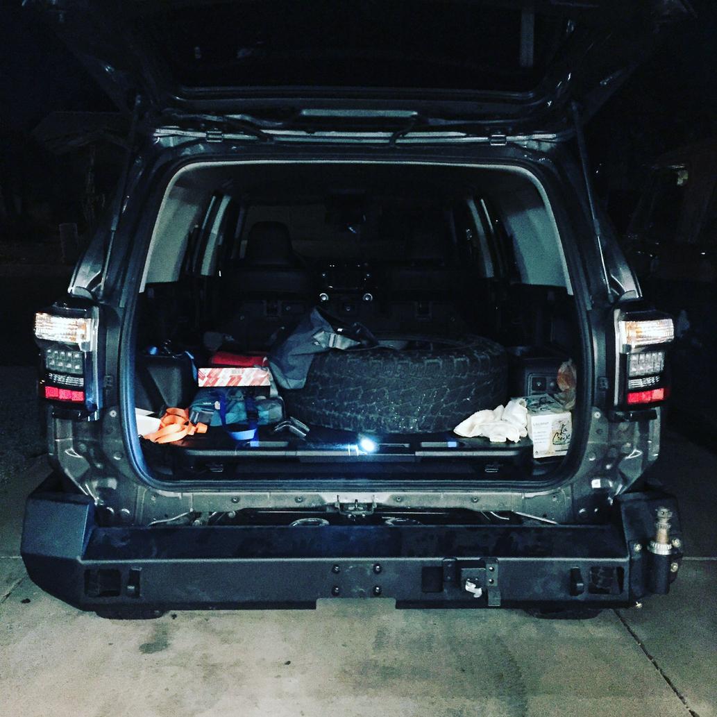

Remove bumper skin and mount the steel bumper. Don’t attach any swing outs until the bumper is on. Measure multiple times to ensure your cut is going to line up. I never got any instructions when I received mine.
Helps to have someone else to help lift the bumper. Let me know if you need any specific pics

Thank you! This should be a good start. I’ll let you know if I need any additional pictures. I just really needed guidance on the cutting.
