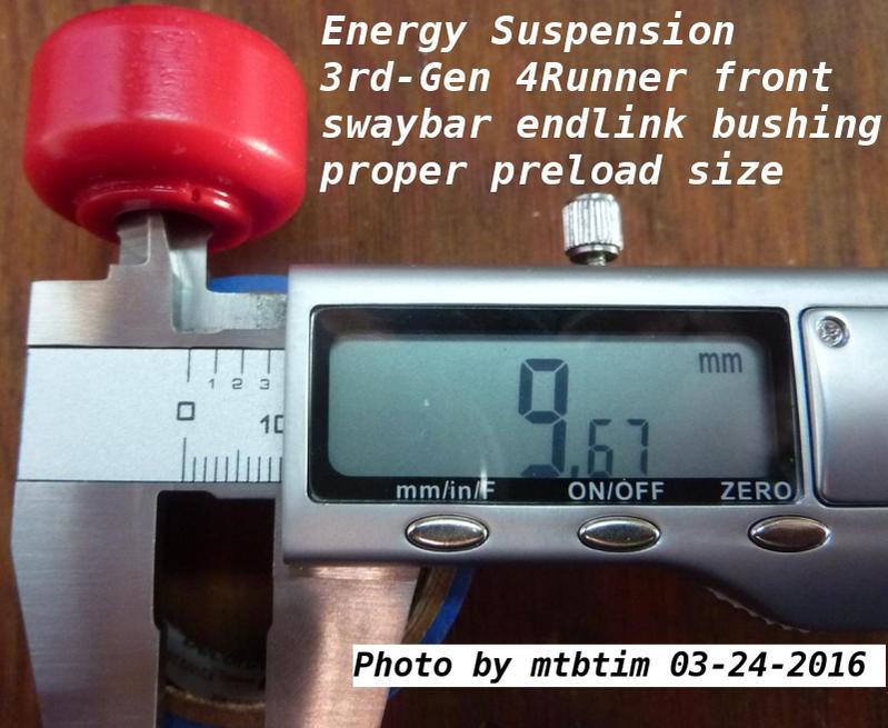

I bought the 18-1115 kit, they look much bigger than 10mm. I also got a 18-1116 kit to get the sway bar bushings for rear and bought rear links for a 95. The 1116 bushings have much smaller diameter, about 9.25mm. I might be able to squeeze those on the front
In my experience of asking questions of Daystar, Prothane, and Energy Suspensions technical support, a good fit (with proper preload) seems to be when the endlink bushings are about 0.5mm (0.020") smaller than the endlinks themselves.
The preload on the endlink bushings also comes from the height of the bushing, so, that's only my humble opinion based on somewhat conflicting stories that came out of Prothane (who, after all, has the sloppiest fit so naturally they'd change their story by saying the inside diameter doesn't matter after it was shown to them how sloppy their fitment is), so, given that (and arguments by some that 5mm of slop in a 10mm hole isn't a big deal), pease take my recommendation of 20 thousandths (1/2mm) preload with an engineer's grain of salt.
However, if you "want" 20 thousandths (1/2mm) of preload, then you'd want to aim for a 9.5mm inside diameter on the endlink bushings (which is pretty much what both Mtbtim (using ES bushings) and I (using Daystar bushings) measured for the snugly fitting bushings we put on our trucks).
