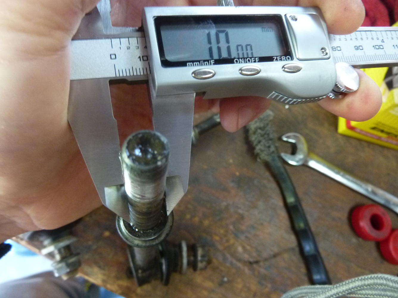

From my research and Foo's research, the bushing should fit tight on the end link post and the below measurements confirm this.
Here's the measurement I got for the End Link Post:

Here's the measurement of the inner diameter of a OEM Bushing:

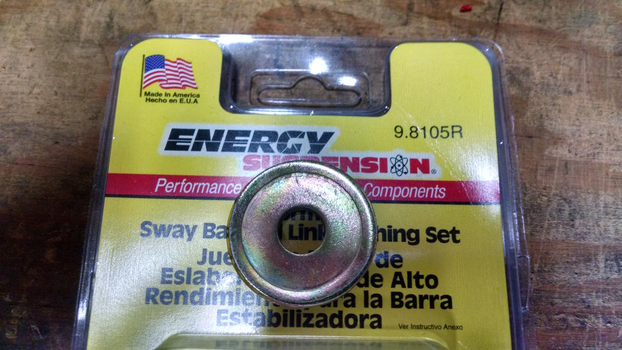

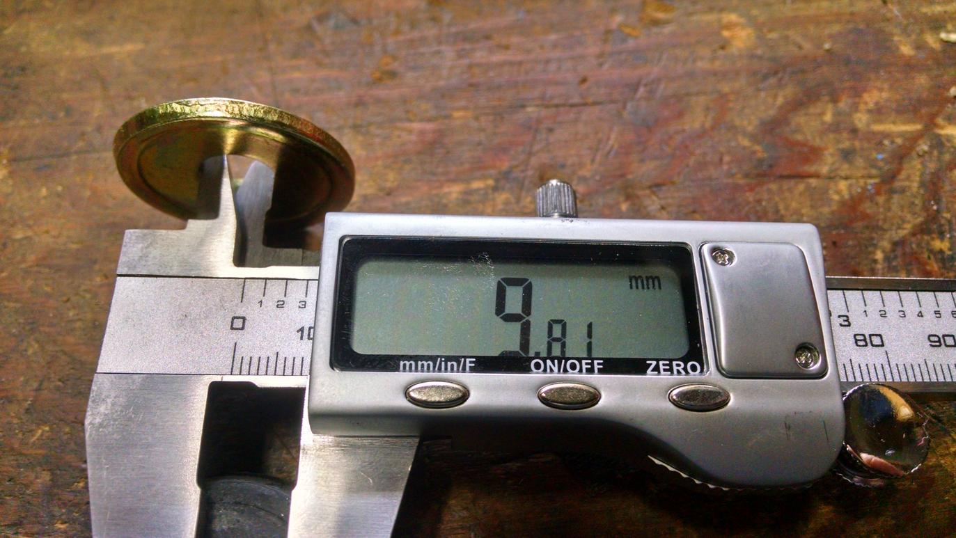

So, I got the bushings and washers in... The bushings fit pretty snug over new OEM end links but the washers will not fit past the top part for the nut... Any ideas?
Well, now I know why you had a problem with those washers from the Energy Suspension Kit 9.8105. The diameter of the hole is only 9.8mm and the end link posts are 10mm wide. So, I gave you some bad information. I was told this kit fit well for our rigs, but maybe the person just meant the bushings and not the washers. The bushings are a good fit.
The reason why I was wondering why you had problems with the washers from the Energy Suspension Kit #9.8105 was because the washers that came with the kit I bought, Energy Suspension #8-5118, came from the same company and silly me to think they would have fit.
So, now I can't recommend anyone buy the 9.8105 kit unless they just want the bushings and not the washers.

Well, now I know why you had a problem with those washers from the Energy Suspension Kit 9.8105. The diameter of the hole is only 9.8mm and the end link posts are 10mm wide...The bushings are a good fit.

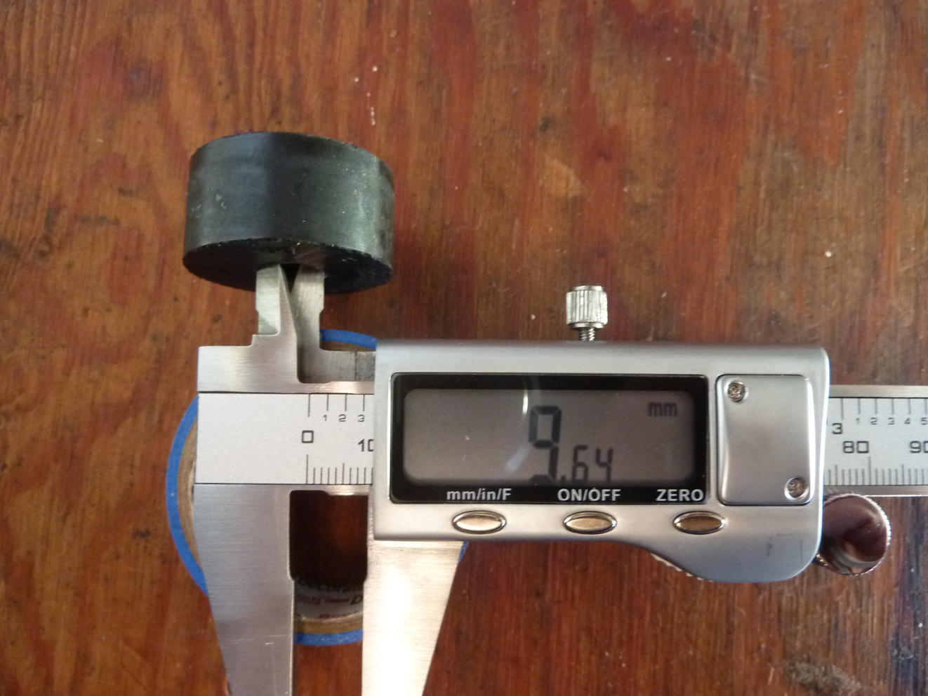

- Energy Suspension  kit 8.5141{R,G}, endlink bushing ID = 9.64mm, swaybar body bushing ID ~= 26mm

- [s]Energy Suspension 9.8105 kit[/s] (containing correctly sized endlink bushings but incorrectly sized steel washers where the steel washers have to be manually drilled about 20 thousandths of an inch just to be able to go over the 3rd-gen 4Runner 10mm endlinks)
