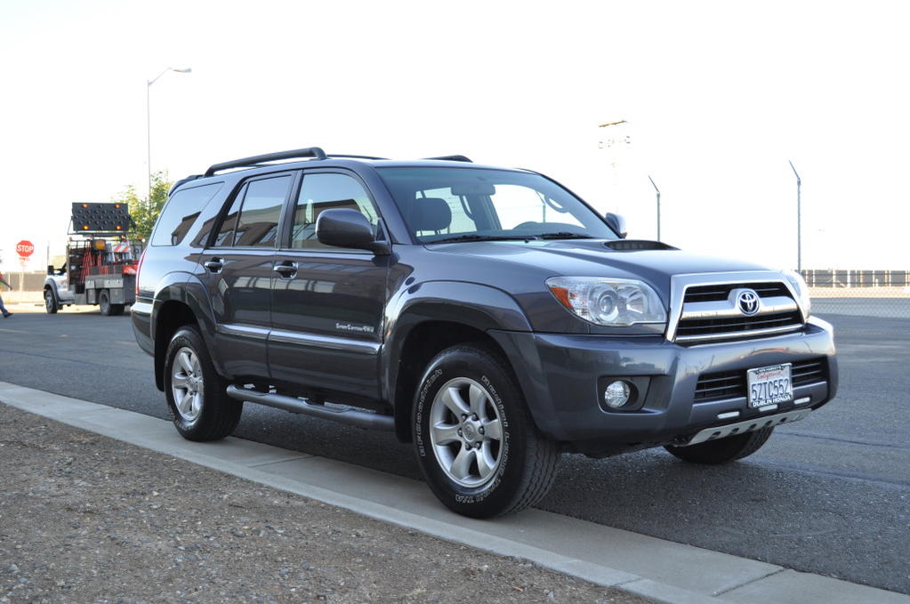

Thanks to some great help on this forum I navigated my way to avoiding some bad 4runners and am the proud new owner of this 2007 4runner Sport v6 4x4!!!
I had it inspected at a toyota dealership prior to purchase. It's in great shape other than a CV boot throwing some grease and two front XREAS shocks leaking. Dealer quoted $2300+ tax. I confirmed they planned to replace the entire system.
i'm planning on putting 5100s in it and FJ springs all around if I can get them. A few questions/confirmations. My driving will be 95% on road and my offroad is probably what this forum would call "light", but hoping to do a bit more.
