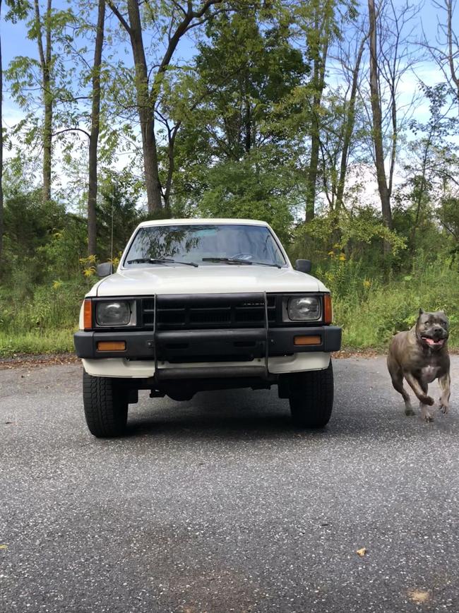

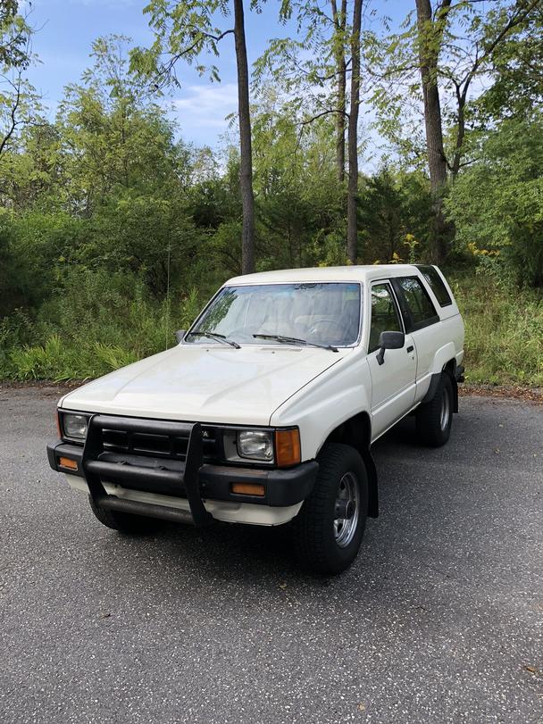

So 6 weeks ago I flew out to LA and bought this 1985 4Runner. I've read so much on these forums I'm getting myself lost and confused, so I'll definitely have questions as I build this thing. :cheers: I had to include a picture with my crazy dog.

You have a pretty clean 4Runner!
It looks like rust is minimal (if any) and has the usual wear spots.
Nice!

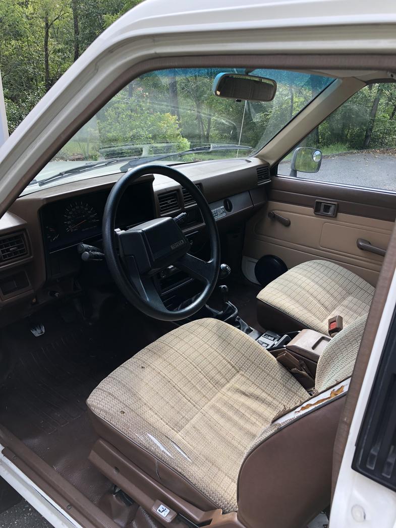

What is that double lever in the steering wheel left side?
It looks like an aftermarket cruise control switch stalk to me.

The original owner installed cruise control. I'm not sure how I feel about it to be honest, but I'm assuming it'll be easy to take off if I want.
The original owner sold it to the guy I bought it from in 2016. I think it spent all but 4 years in southern CA, with the others in Washington State. The guy I bought it from had like 10+ old toyotas - FJ40's, FJ45's, lots of cool stuff. This one has 208K miles on it.
The frame is in great condition, no rust I can see, but there is some minor rust in a few places.
Supposedly original paint, but it was buffed down to the primer in some places unfortunately.

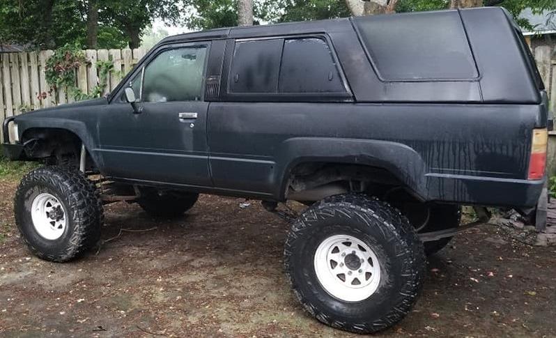

Looking really closely at these pics, I can see one problem very clearly - IT'S NOT MINE!
