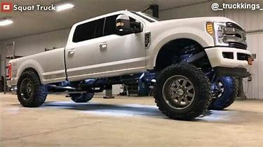

Don't forget that lift and bigger tires have an effect.... that is unless you do that Carolina Squat thing which signals aliens your a$$ is available for probing!
