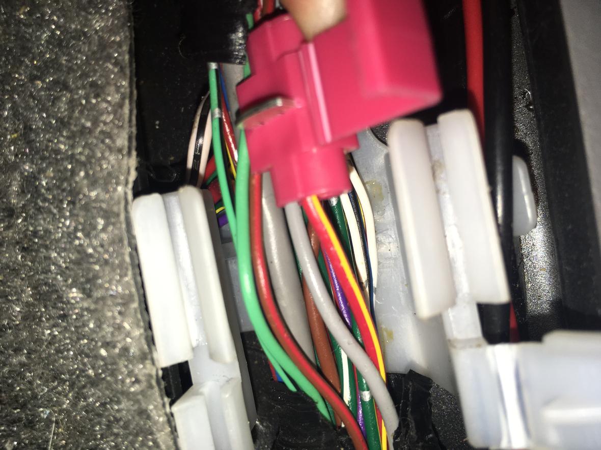

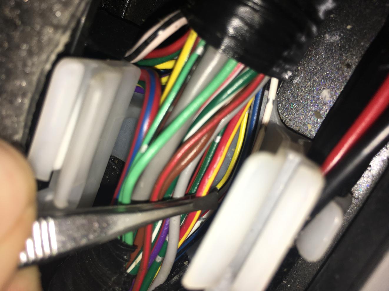

For the love of Zeus, after weeks of working around, I got my camera to work. I would like to do a write up in a build thread or something, but this Photobucket crap has really messed with my motivation to do so.
Anyway, I used the the harness that was posted here earlier with the fuses and stuff. I got mine on eBay, I think from the same seller as autoharnesshouse. It probably would have worked with my old harness, but this solved the trying to tap 12v power to the camera problem. One big issue is the plug wouldn't fit in my radio without some persuasion from a razor and dremel.
Lastly, I had to add a reverse wire to my 24pin connector. The harness I purchased came with one that has the pin and everything. I just inserted it into my connector.
I ended up tapping that red/yellow wire in the driver door sill and that made the camera work flawlessly. It was in the center of the loom toward the bottom. Overall, I'm not pleased with the camera. It's better than nothing, but it's not as wide view as I had hoped, it's off center, and I can't see my bumper which helps me gauge distance. I probably can't do anything about the off center, but may look into different camera options.
I wired up everything with quick disconnects instead of butte connectors so I could easily replace components in the future if they fail. But damn what a PITA this whole adventure has been.
Here's pics of the wire I tapped in the driver door sill. I had to cut away a little tape on both ends to give me room to work/manipulate the wire.
